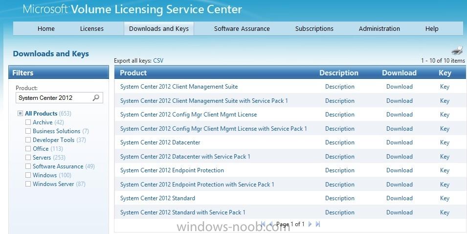

That's odd...here's what I see in our volume licensing download section when I search just for "System Center 2012"...you can see the RTM products, and then below them are their SP1 counterparts. -

If you have a volume licensing agreement, then you can download the non-SP1 version there. Unfortunately, just the boot.wim file will not work...it needs to be the "boot.TST0001.wim" file that SCCM creates, so that it has all the CM components with it. Does anyone know what all is included with the modified boot.wim that CM creates? I wouldn't have a problem sharing it out, if I knew for certain that there wasn't any info stored in the those binaries that could be used to compromise my CM environment on some level. -
