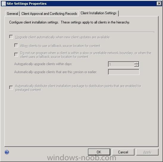

Update, update, update! CM2012 SP1 + SQL2012 + client updates
h4x0r replied to h4x0r's topic in Configuration Manager 2012
I found the solution, at least for me...I came across this thread and it occurred to me that I was logged into the console with a different admin level account than what I actually installed SCCM with. This is one case where my installation differs from Nials' guides, in that I used a local admin account to install everything initially. That being the case, I logged on as the local admin and sure enough, the option to allow automatic client updating was available to me. Hope this helps! As an aside, is there a simple solution to this installation account issue?- 13 replies
- sql 2012
- client update
(and 1 more)
Tagged with:

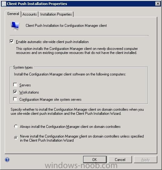

Here are the screenshots from the site hierarchy settings for automatic client update. We presently only have Client Push enabled, since (as mentioned earlier) our WSUS is managed up-stream by a third party. The client push settings obviously use our network service account, and our own system site code (those tabs were not included in the screen shot).- 13 replies
- sql 2012
- client update
(and 1 more)
Tagged with:
