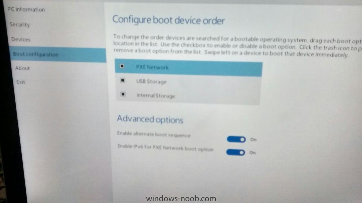

I have set already 1. PXE network 2. USb storage 3. internal storage.
Since have only one usb port on the device i have to remove usb and connect usb-Ethernet adpater is the only option i have.
Even though i am not getting and significant message/screen displays related to PXE boot...
Is there any firmware update required?
I have attached the boot order screenshot
