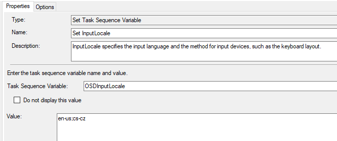

Question, If I'm needing to install a total of 5 languages in addition to English on a lab of computers can I modify the collection they all reside in to install all of the languages or does it just limit it to the default language of the os and one additional language?
2 hours ago, anyweb said:
yes you can do that, but if you are installing more than one language then you must include all the language packs you intend to install together
Can you give example? When I try and add a second RegionValue I get the following error.
2018-08-01 12_19_21-System Center Configuration Manager (Connected to UCA - University of Central Ar.png
