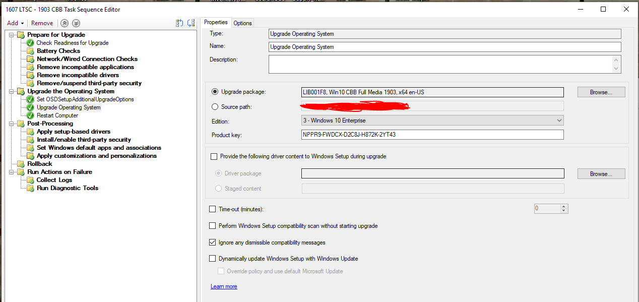

I'm using the "upgrade operating system task sequence", using the full media for 1903 x64 Semi Annual Channel (formerly CBB I believe). My attempt is to go from 1607 LTSB to 1903 CBB. I have an OSDSetupAdditionalUpgradeOptions specified, as the entry for Product Key didn't seem to put the "/pkey" into the command line.

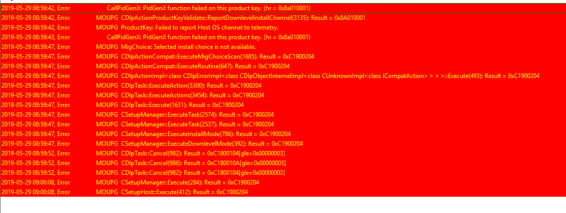

From smsts.log on a box that was affected, this is the resulting command it is running. Shortly after it fails with the "unknown error 0x80004005", I check setupact.log and setuperr.log and it shows the the following errors:
One thing that sticks out is "Selected install choice is not available".
