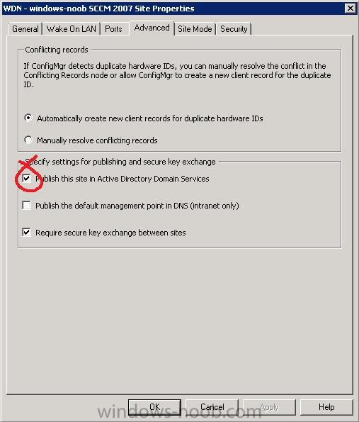

Step 3. Publish this site in Active Directory Domain Services
Note: In Configuration Manager, Verify that the following setting is set
Highlight your SCCM Site right click, choose properties, Advanced.
For specify settings for publishing and secure key exchange
make sure to Select publish this site in active directory domain services
