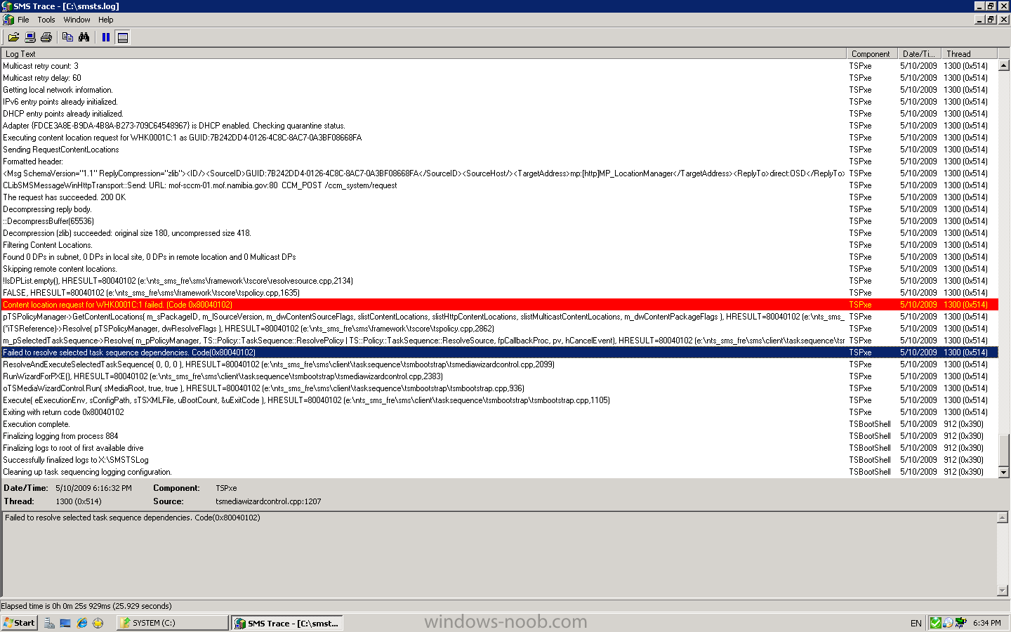

i am a bit stuck with a problem where i can pxe boot a computer(bare metal), its gets to the screen where it says its loading winpe (background image is from sccm), preparing network connections etc & then it sits there for 1-2 minutes & it reboots. the task sequence does not load.

content location failed, which means it can't find the content,
make sure to distribute your package to a distribution point (update distribution point if unsure)
A little side note:
When you just created a new package and you copied it to a distribution point then you have to wait a few seconds/minutes till its actually installed on the distribution point. (check your package status)
And if you do a quick PXE boot then your TS will fail if the DP isn't updated yet.
