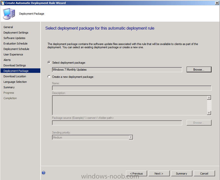

Witcher 0 Posted November 6, 2012 Report post Posted November 6, 2012 Anyweb, first thank you for this helpfull part! I have still one question during recreating an identical ADR: Do i have to add the identical rule to an existing Software Update Group or new SUG? Kind Regards Witcher Quote Share this post Link to post Share on other sites
anyweb 480 Posted November 6, 2012 Report post Posted November 6, 2012 Do i have to add the identical rule to an existing Software Update Group or new SUG? create the rule as you did before, so choose 'create new software update group' this will allow you to run compliance reports for that months patches otherwise all the patches would end up month after month in the same software update group and you'd have a problem trying to determine last months compliance Quote Share this post Link to post Share on other sites

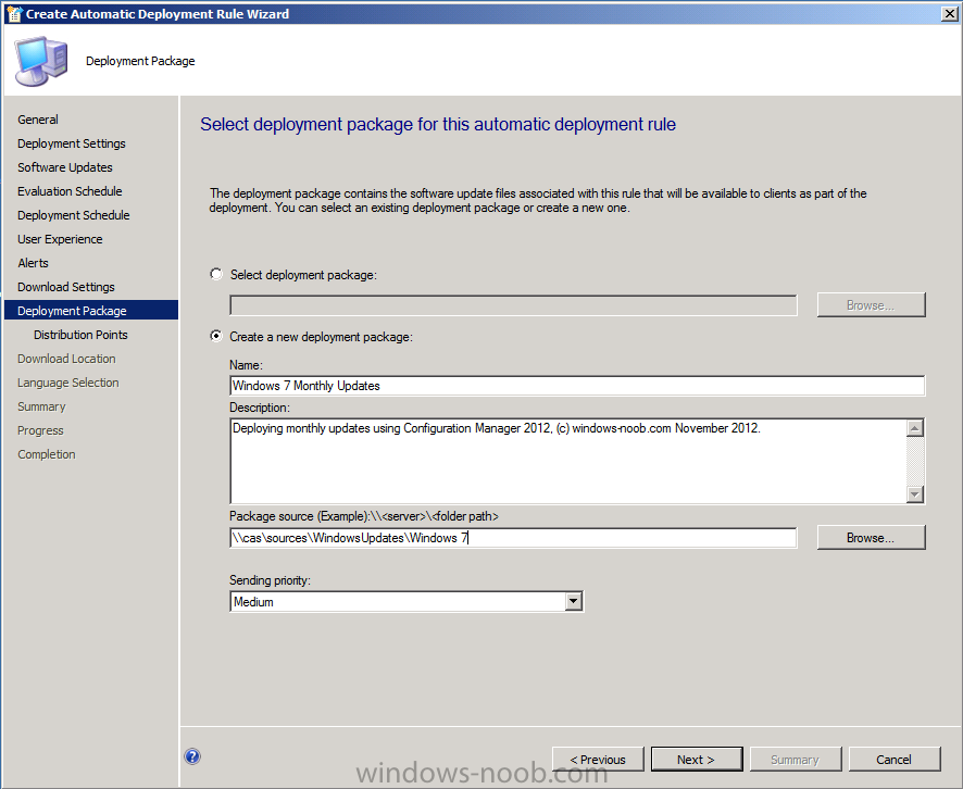

sccm2012noob 0 Posted December 5, 2012 Report post Posted December 5, 2012 Great tutorial but I have some questions I'm hoping you can answer: 1. Under step #3, the screenshot directly below "So Below screenshot is from the first run of the ADR." shows a package source (\\cas\sources . . . ). Did you create this manually? The "WindowsUpdates\Windows 7|" sub-directory is not in my sources folder so I couldn't choose it. Do I have to create it manually? Also, what does it do? There really isn't an explanation unless I missed it in one of the other tutorials. 2. You mention creating the ADR, running it, disabling it, and then recreate the rule (selecting the package the first rule created). When I try to recreate and name the rule and "Select Deployment Template", it says one with that name already exists. This makes sense but I see your screenshot shows two rules with the same name. Am I doing something wrong? Thanks for any help you can give. Quote Share this post Link to post Share on other sites

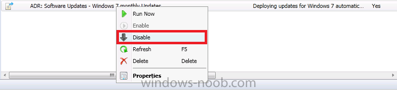

MagnumVP 6 Posted December 19, 2012 Report post Posted December 19, 2012 What's the point in Disabling the ARD once you created it? Don't you still want it to run every month? Quote Share this post Link to post Share on other sites
anyweb 480 Posted December 20, 2012 Report post Posted December 20, 2012 What's the point in Disabling the ARD once you created it? Don't you still want it to run every month? you create the ADR to create the deployment package, once done you disable the ADR and recreate it as before, except this time you re-use the previously created deployment package, this is to avoid recreating the deployment package every time the ADR runs... Quote Share this post Link to post Share on other sites
anyweb 480 Posted December 20, 2012 Report post Posted December 20, 2012 Great tutorial but I have some questions I'm hoping you can answer: 1. Under step #3, the screenshot directly below "So Below screenshot is from the first run of the ADR." shows a package source (\\cas\sources . . . ). Did you create this manually? The "WindowsUpdates\Windows 7|" sub-directory is not in my sources folder so I couldn't choose it. Do I have to create it manually? Also, what does it do? There really isn't an explanation unless I missed it in one of the other tutorials. yes you have to create that folder manually, it's simply there to store the contents of the Windows 7 Updates for the windows 7 deployment package 2. You mention creating the ADR, running it, disabling it, and then recreate the rule (selecting the package the first rule created). When I try to recreate and name the rule and "Select Deployment Template", it says one with that name already exists. This makes sense but I see your screenshot shows two rules with the same name. Am I doing something wrong? simply add a space or fullstop or rename the original ADR slightly to get the desired result, no you are not doing anything wrong, mine has an extra space (from memory..) Thanks for any help you can give. you are welcome Quote Share this post Link to post Share on other sites

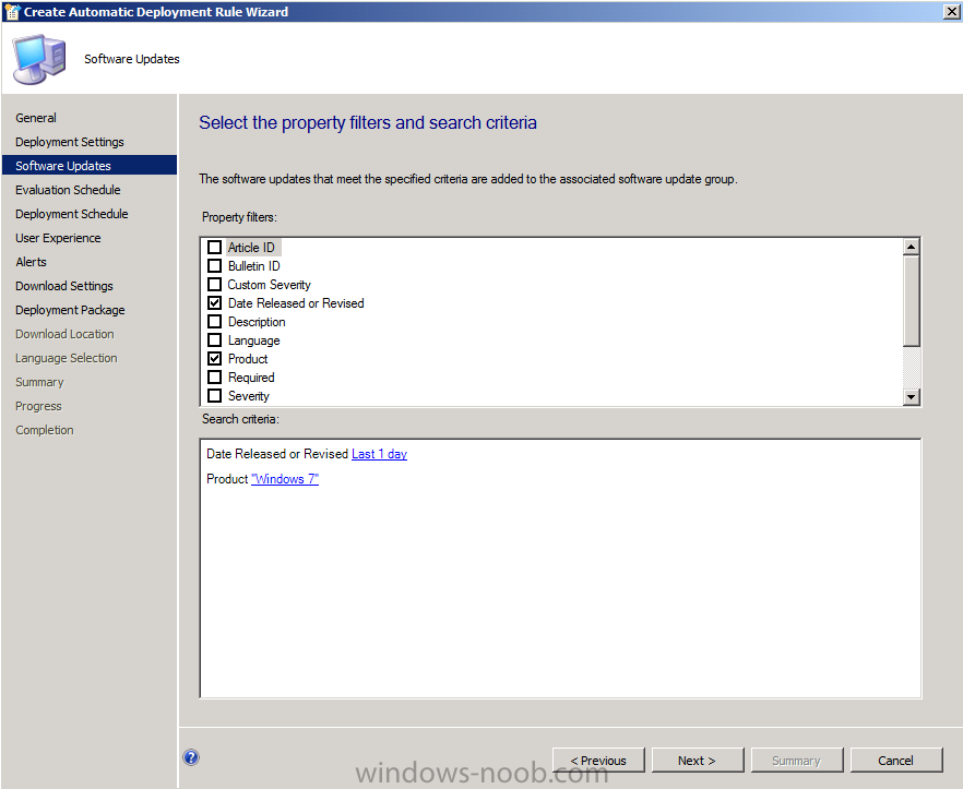

MagnumVP 6 Posted December 21, 2012 Report post Posted December 21, 2012 Would a "Best Practice" be to; Date release or revised Last 1 Month This would allow the updates to catch any "out of cycle" patches that MS might push out? Since the update ADR is only running once a month. As alternative you could run this ADR daily and still keep it at Last 1 Day. Do you have to keep the Disabled ADR's or can I just delete them? Quote Share this post Link to post Share on other sites
anyweb 480 Posted December 22, 2012 Report post Posted December 22, 2012 if you want to do it that way in production go ahead, but you'll have a hard time keeping track of what is going out to your systems and when, by setting it to Last one day and scheduling it to occur just after patch tuesday once per month, you are deciding when and where your systems get patched. Quote Share this post Link to post Share on other sites

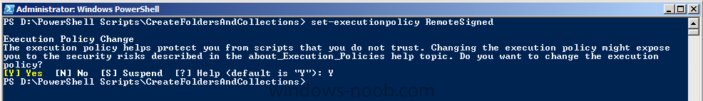

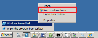

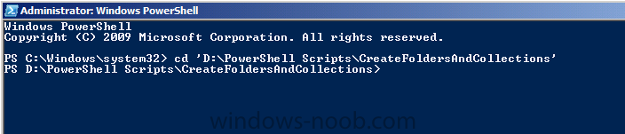

lightiv 1 Posted January 18, 2013 Report post Posted January 18, 2013 When I tried to execute the script I got the following error: File C:\temp\CreateFoldersAndCollections.ps1 cannot be loaded. The file C:\temp\CreateFoldersAndCollections.ps1 is not digitally signed. The script will not execute on the system. Please see "get-help about_signing" for more details.. Any suggestions? Quote Share this post Link to post Share on other sites
anyweb 480 Posted January 18, 2013 Report post Posted January 18, 2013 When I tried to execute the script I got the following error: File C:\temp\CreateFoldersAndCollections.ps1 cannot be loaded. The file C:\temp\CreateFoldersAndCollections.ps1 is not digitally signed. The script will not execute on the system. Please see "get-help about_signing" for more details.. Any suggestions? did you read the guide ? Once done we need to Set the Execution Policy to allow this script (RemoteSigned) to run. Set-ExecutionPolicy RemoteSigned Quote Share this post Link to post Share on other sites
Rocket Man 40 Posted January 18, 2013 Report post Posted January 18, 2013 Another query: How do I send the same ADR to another collection. I have office 2013 updates that at the moment are deployed via ADR to my windows 7 collection, I also want to deploy this ADR to my windows8 collection. Do I have to create another ADR and point it to the office 2013 update source directory(that was created from my windows7 ADR) and then deploy this new ADR to the windows8 collection. Will this work, 2 ADRs' using the same source directory?? Thanks Quote Share this post Link to post Share on other sites
lightiv 1 Posted January 22, 2013 Report post Posted January 22, 2013 did you read the guide ? Sorry, I didn't mean to be a pain but yes I did read the guide. Your guides are very appreciated and have greatly accelerated our deployment. Here is my PowerShell window. Quote Share this post Link to post Share on other sites
lightiv 1 Posted January 23, 2013 Report post Posted January 23, 2013 If anyone should run into the problem I ran into I follow the following to get the scripts to run. You will have to do it to both CM12Functions.ps1 and CreateFoldersAndCollections.ps1. 1. Save the script file on your computer.2. Click Start, click My Computer, and locate the saved script file.3. Right-click the script file, and then click Properties.4. Click Unblock. Quote Share this post Link to post Share on other sites
