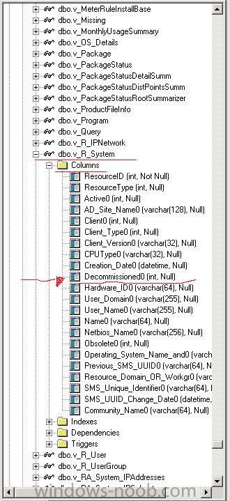

I currently don´t have access to my laboratory (moving it).
But i would start by checking that my "Decommissioned0" Column was spelled correctly in my dbo.v_R_System.
To do this log on your SQL Server
Open Management Studio (SQL 2005) or Enterprise Manager (SQL 2000)
Expand your SMS Database
Expand Views
Find the view called "dbo.v_R_System".
Check that the Column "Decommissioned0" is named correctly.
Here is a pickture from a SMS 2003, SQL 2000 Enviroment.
Btw are you performing a clean install of SCCM or are you trying an upgrade from SMS 2003? Do you have more then one DB server or what do you mean by?
I have this error on all the servers just installed with SCCM???
Allso check your colleval.log (can be found on "<SCCMSERVER>\\<SCCM DIRECTORY>\LOGS") if you find any relevant information regarding this error.
