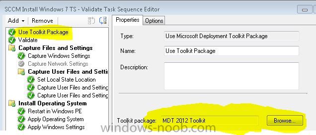

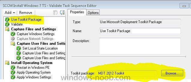

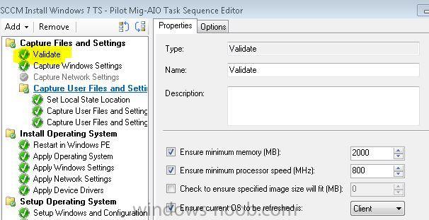

	Hello Guys I'm having trouble getting the 'Validate' step in my task sequence to run. Has anyone successfully done this? The task sequence fails everytime it runs the validation step. ----------------------- I believe I have found the solution to my problems after reviewing the smsts log file. I need to add the "MDT - Use Toolkit Package" and reference my MDT 2012 Toolkit package that I created, to the beginning of the task sequence (before Validate) When I run the task sequence this time, it is not failing. I will update you guys.

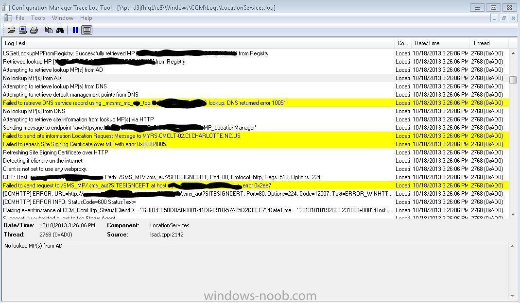

	Hey Guys, I'm wondering if you have encountered this error that occurs during OSD, after the client has installed. We notice that applications fail to install during OSD and it may be due to this issue i found in locationservices.log - The client does eventually manage to find the SCCM Servers, but only after the applications have failed to install... I can run the same task sequence on one machine and have it succeed, but fail on another (with these error messages). The time stamps match up exactly to CIDownloader log files as well. Management point looks good and i don't see any errors on them.

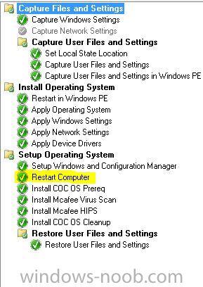

It does reboot after the client installation. the additional reboot kicks off after 'initializing the client.' this seems to have made a huge difference on app installs. we are still doing further testing but 6 out of 6 machines imaged successfully is not bad, where before we would get about 50% success. -

thanks, we have that option selected. I have seen much more positive results after adding a 'reboot' task after the configmgr client installs.. after the system reboots, the applications seem to install better. Could there be an issue with the client not fully initializing before the "install applications" task begins? i will let you guys know how well this works. so far, it is promising! -

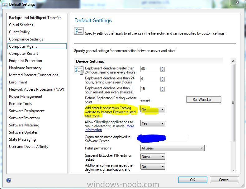

	Hey Guys I have a quick question about the 'default client settings.' In our environment we have the Application Catalog website added to the trusted sites zone in IE...would we still need to enable the setting under Computer Agent: "Add default application catalog website...." ?? Asking because some of our systems have problems accessing the app catalog, even though an existing GPO takes care of the trusted sites. Thanks!

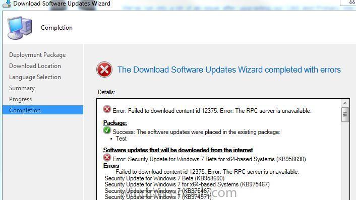

	i ran into a similar situation earlier this week: http://www.windows-noob.com/forums/index.php?/topic/8841-rpc-server-unavailable-downloading-software-updates/ maybe check your sms provider to see if it's correct?

l.hv.yang replied to l.hv.yang's topic in Configuration Manager 2012
Got it fixed! I checked the smsprovider following these steps: http://social.technet.microsoft.com/Forums/systemcenter/en-US/f3961228-686b-490e-b3fc-f748d921c876/how-do-i-know-where-is-the-sms-provider-computer-installed I noticed that there were two entries for our primary site...One entry was NOT right (had the server name wrong) Once i deleted that entry, i was able to download the software updates. This might explain why we are having issues connecting to our primary site from time to time. -
	Hey Everyone. We've run into a bit of an issue after upgrading our CAS and Primary Site to SP1. If I connect to my CAS site, I am able to download software updates. If I try to do the same thing by connecting to our Primary Site, I get an error message that says this: "Failed to download content id 12375. Error: The RPC server is unavailable." Before upgrading the sites, everything was working correctly. Just wondering if any one else has run into this issue. Any tips? Thanks!
