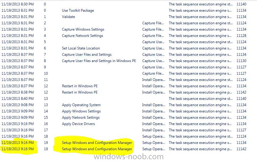

Definitely take a look at how you're applying the driver packages. We ran into this as well with Dell Optiplex 980 not getting past Setup Windows/Config Mgr. Use WMI Query for drivers!

Turns out the systems were pulling down the wrong device drivers! I had to modify my task sequence to not automatically select drivers, but had to specify which driver package to install based on PC model. Hope this helps anyone who runs into the issue as well.

Hey Guys We're running into some issues where the task sequence will hang at: "Setup Windows and Configuration Manager." I'm seeing this occur mostly on Optiplex 780s, and I'm not leaning toward isolating it toward that model, because we do have successes with that model. It's difficult to get a copy of the logs, since the PC is in a remote location. The last step is: "the task sequence engine performed a system reboote initiated by an action." Have you all run into this issue?
