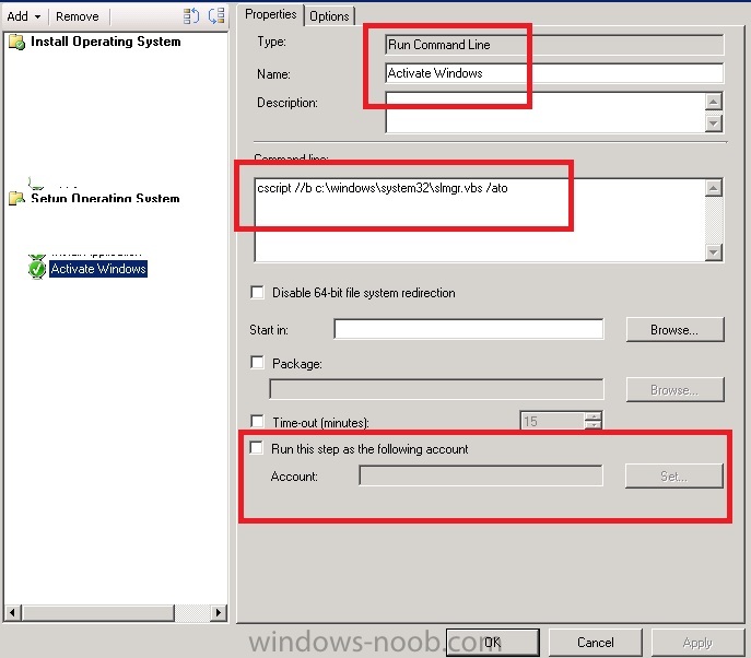

make sure the activation step is after first reboot i add it after install OS and all application... and use account have local admin like your help desk account see attached picture.

try this cscript //b c:\windows\system32\slmgr.vbs /ato let me know whats the result please ~MOhanad
