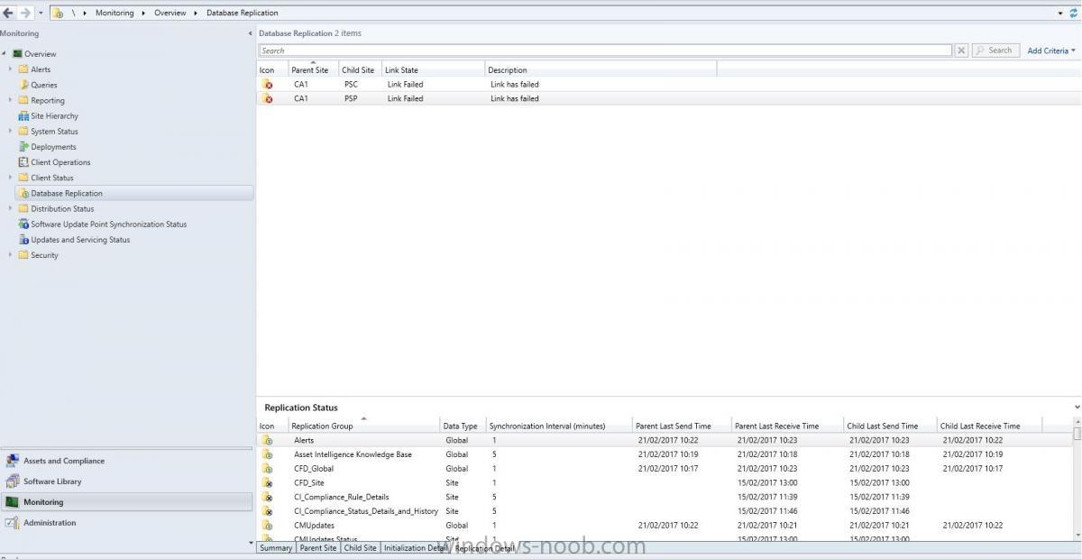

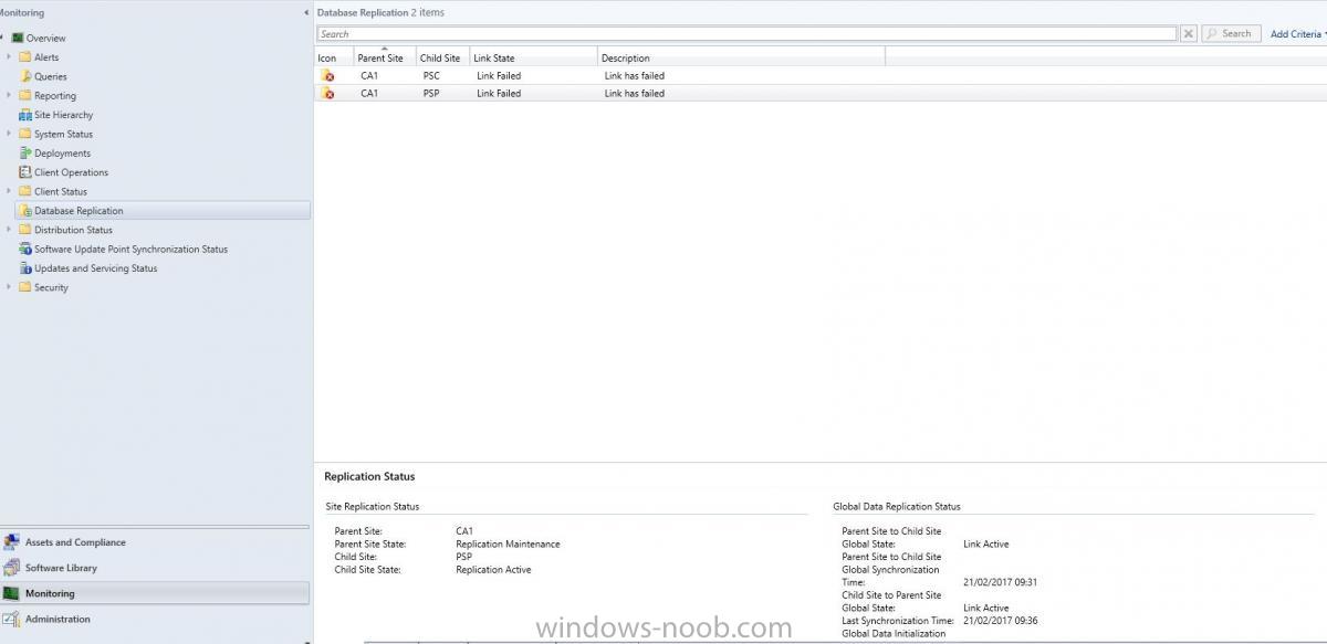

Hi, We have just update our 3 SCCM servers with CU 1606. We have a CAS and 2 primary site servers. Since the update the CAS replication has gone into "Replication Maintenance" The global replication ist still working but the site replication has failed since the update. When we run the Replication Link Analyser it is all green, I believe it doesn't realise there is an issue as no site replication has taken place and this is just reporting on pre-update info. We have run the fowling in SQL and there are a number of entries that aare not 7: update RCM_DrsInitializationTracking set InitializationStatus = 7 where ReplicationGroup in (select replicationgroup from vReplicationData where ID in (select ReplicationID from RCM_ReplicationLinkStatus where SnapshotApplied <>1))and InitializationPercent not in (0,100) Has anyone come across this or can help? I have attached a couple of files that may help explain the issue. Thanks Kevin
