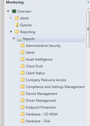

Ah thanks for this. I'll take a look. I didn't get a notification for this for some reason (they are turned on), so sorry for the slow reply. I don't see the BitLocker category under 'Reports' at all. I know that we do not use PKI certificates, so having had a quick glance at your posts, I guess this could cause a problem down the line with using the integrated BitLocker features, but shouldn't the reports at least be visible since I upgraded to 2107?
I'm looking to use the built in BitLocker reports. https://docs.microsoft.com/en-us/mem/configmgr/protect/deploy-use/bitlocker/view-reports I am running config mgr 2107, so believe they should be there, but I don't see them. Does anyone know how I make them appear? I've only just enabled the Bitlocker Management feature. Is this a factor? We do not use config mgr to administer BitLocker but I'm hoping that I can still access the reports. It doesn't look like I have any new reports available since upgrading to 2107. Thanks!

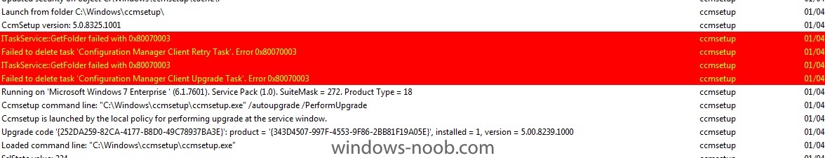

I recently upgraded from R2 to 1511 and set the hierachy settings to auto update clients. This worked on a couple of test machines but failed on two others. The scheduled task appears after a policy retreival but when it runs it fails with the errors below. Can anyone help? i'm new to SCCM and struggling with this one. It seems to be failing with pre reqs (.NET i think). Thanks.

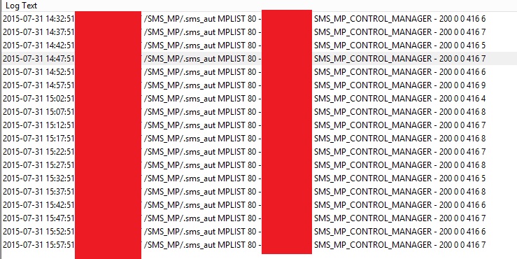

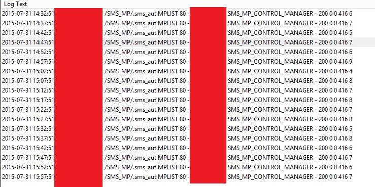

Client deploys but doesn't register / see MP
PH25 replied to PH25's topic in Configuration Manager 2012
Hi, It's looking like this might have been a central firewall issue, it's been flagged up and a firmware upgrade is taking place, so fingers crossed it might kick into life tomorrow. I don't think the rules in place were actually taking effect. Thanks for all your help, i'll write back if this is solved. -
Yes, the IP of the client does appear in the logs -
It will be for that client, as i've only deployed to one client so far as a test. I'm confused how this part can look ok, yet im getting 'failed to send management point list location request' and 'GetDpLocations failed'. What's the next thing for me to check? Thanks again for your help -
I've also tried with local firewalls on server and client turned off. Config manager on the client has a site code but seems to not be talking to the MP (everything is on one box in our setup) - despite config manager properties saying 'Assigned Management Point - <SERVER NAME>' -
I can't seem to find IIS logs. Shouldn't they be in %WINDIR%\System32\logfiles\W3SVC1 ? i can't see this folder - perhaps i dont have IIS logging turned on?
