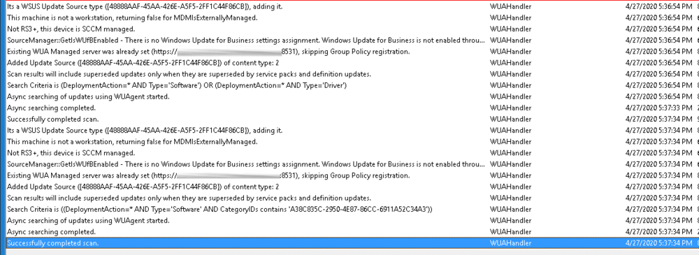

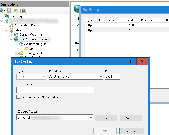

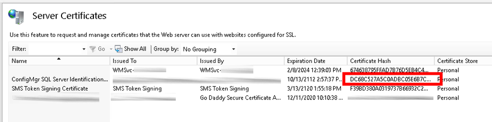

I was able to get it resolved. Rebooting the server didn't help...... IISRESET was the key. It pushed the bindings down through all the areas needed. Now client can scan server successfully. Thank you everything for listening to me talk this out loud and work through it.

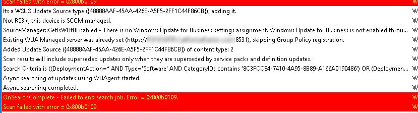

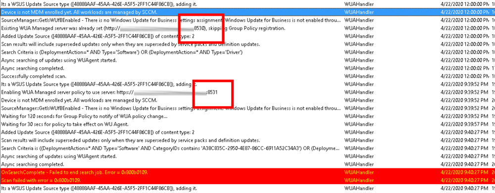

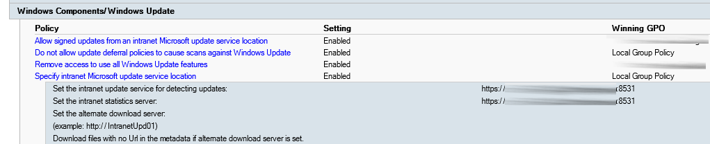

Client logs show: 0x800b0109 I have done all the standard checking for this error and nothing seems to resolve it. I'm allowing Third Party certs via GPO to all clients but they just won't scan. I exported the cert from the server and imported it on the client (which actually shows two in both locations because SCCM client put there there for me). All the logs indicate that it occurred last Wed the 22nd. This corresponds to the time I enabled 3rd Party Software Updates which generates a new SSL Cert. I have checked the client certs and the Self-Signed WSUS created by the the thurd party enable is in both locations. What should the IIS "WSUS Administration" Server use for Bindings to port 8351? Where else can I look to make sure I'm using the correct cert? One other interesting note I have noticed. In the client when I navigate to https://wsusserver.domain.com:8531/ClientWebService/client.asmx I receive a certificate error. The "WSUS Administration" site on the WSUS Server (SCCM) is set to our companies Universal SSL Certificate.However, from the client when I navigate to the https site it's pulling the Server SQL Cert that expires in 100 years. On the client if I view the cert in the browser and install it under the "Trusted Root Certification Authorities" the client scans successfully. So my questions is, why does the Binding on the WSUS Administration site not flow down into the ClientWebService?

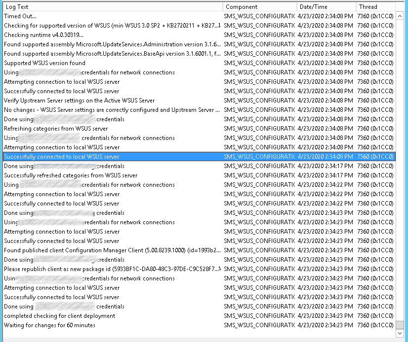

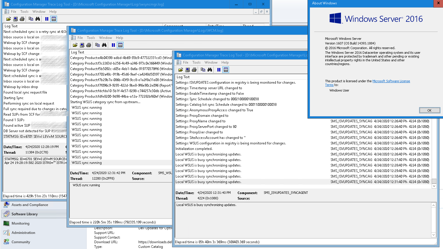

Steps I took so far...which looks promising. Removed the Software Updates Roles from SCCM - Monitor SUSSetup.log Rebooted Removed WSUS as described in the link. Rebooted Updated OS to Server 2016 Installed WSUS as described in the link using SQL default Instance Do NOT run the Post install command....yet. Open Services and change W3SVC and WAS to automatic (default is DISABLED) and start Run the post install SQL script to create the directories and DB Open IIS verify Application Pool WsusPool and WSUS Administration Site is created. Install Software Updates Roles within SCCM (MECM now) - Monitor SUSSetup.log Perform Software Sync - Monitor with WCM.log and wsyncmgr.log hopefully the initial sync completes without issues. Fingers crossed. EDIT: Looks to be syncing just fine.

I think I have found the underlying issue. The server was upgraded from 2008 R to 2012 R2 and the WSUS DB wasn't uninstalled prior to upgrade. The WSUS is corrupted (Update Service won't start as one issue). I'm going to work on rebuilding the WSUS DB using this link I found. Hopeful it fixes it. https://www.ajtek.ca/wsus/how-to-remove-wsus-completely-and-reinstall-it/ I'm considering upgrading to Server 2016 prior to fixing so I don't have to worry about this again in 2023.
I think I have found the underlying issue. The server was upgraded from 2008 R to 2012 R2 and the WSUS DB wasn't uninstalled prior to upgrade. The WSUS is corrupted (Update Service won't start as one issue). I'm going to work on rebuilding the WSUS DB using this link I found. Hopeful it fixes it. https://www.richardwalz.com/sccm-reinstall-wsus-susdb/ I'm considering upgrading to Server 2016 prior to fixing so I don't have to worry about this again in 2023.

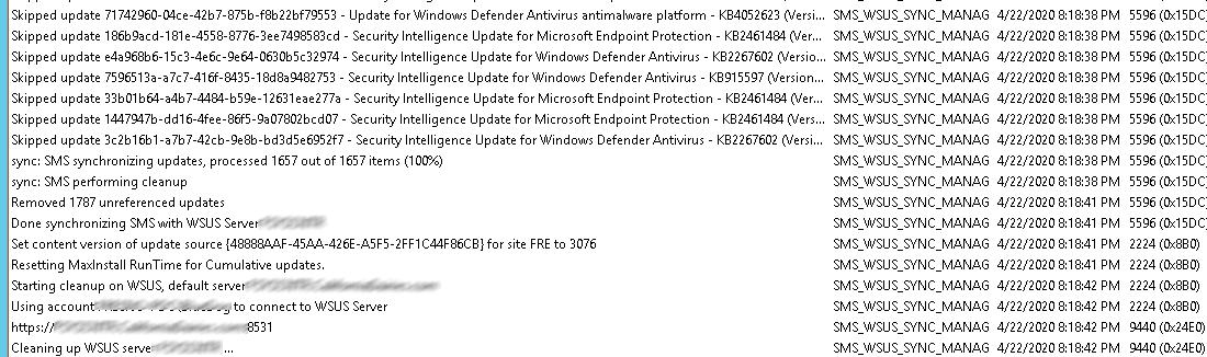

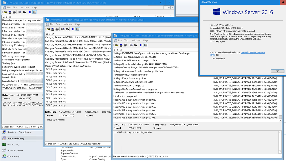

The SMS_ISVUPDATES_SYNCAGENT.log is showing "Unable to Connect to local WSUS Server" every minute ans has been for days (the log only goes back 3 days and it's full with these messages). I recently performed an in-place upgrade from 2012 R2 to what is now 1910 with Hotfix. So far everything seems to be working as expected but notices this last night and I'm not sure where to look. I can connect to the local SQL DB where WSUS DB is located and connect to the SCCM DB as well. This is the only Software Update point and syncs with MS directly. However, the WCM.log shows a success.
