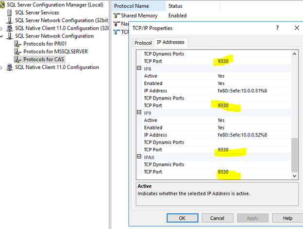

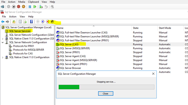

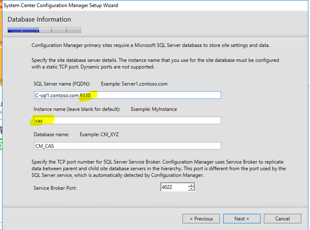

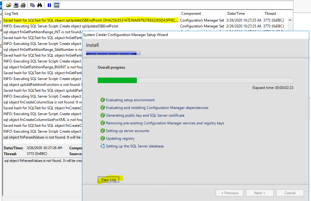

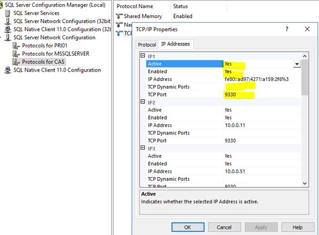

SCCM SETUP WITH DIFFERENT SQL PORT SQL SERVER CONFIGURATION MANAGER: Make sure all TCP Dynamic Ports are blank For every IP interface change the "TCP Port" field to your chosen static port For the "IP All" Interface change the value of the "TCP Port" field to your chosen Static Port Restart the SQL Engine : ON SCCM SETUP (CENTRAL SITE, PRIMARY SITE) Use comma and port number to specified port besides FQDN Continue with the setup as usual. You could do the same when setup WSUS Database, SCCM Primary Site Database, ... Continue monitoring the status of setup progress by clicking on view log button
