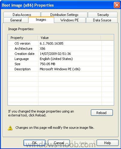

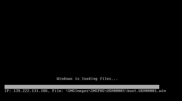

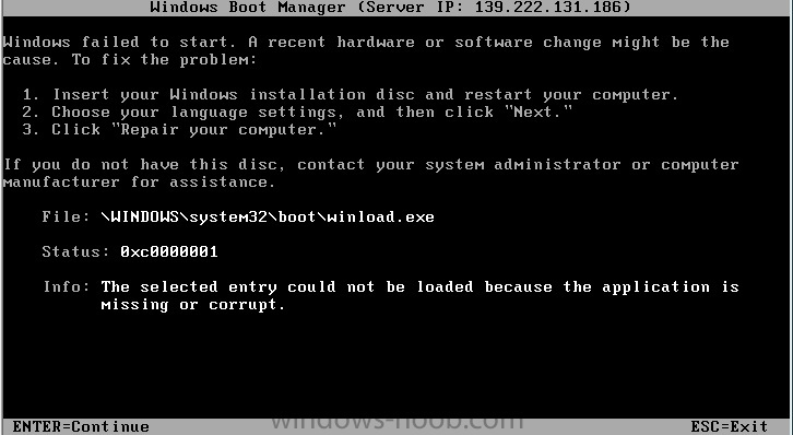

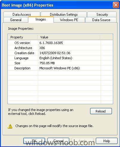

hi all OSD issues im afraid. 64 rolls out a treat. x32 has been working for ages, however I am now getting this issue. I have googled and searched forums here and have done all the checks which come back as correct version etc waik3.0 so i am starting to think the file is corrupt ? sccm will roll out 64bit win 7 no worries fails on 32 bit roll outs with the following any ideas what next ? sad
