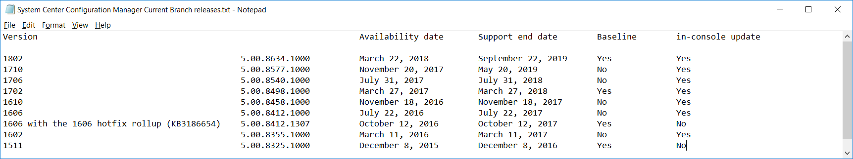

The following versions have been previously released since Microsoft moved to the Current Branch release cadence for Configuration Manager:
Source Microsoft.

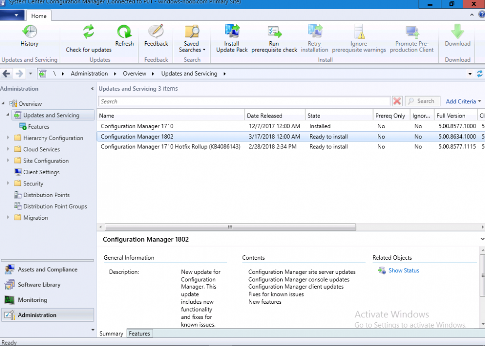

Next, open the ConfigMgr console and find Updates and servicing in the Administration node. Click on Check for Updates in the ribbon, followed by Refresh. After a few minutes you should see that Configuration Manager 1802 is listed with a state of Available to download as shown below.

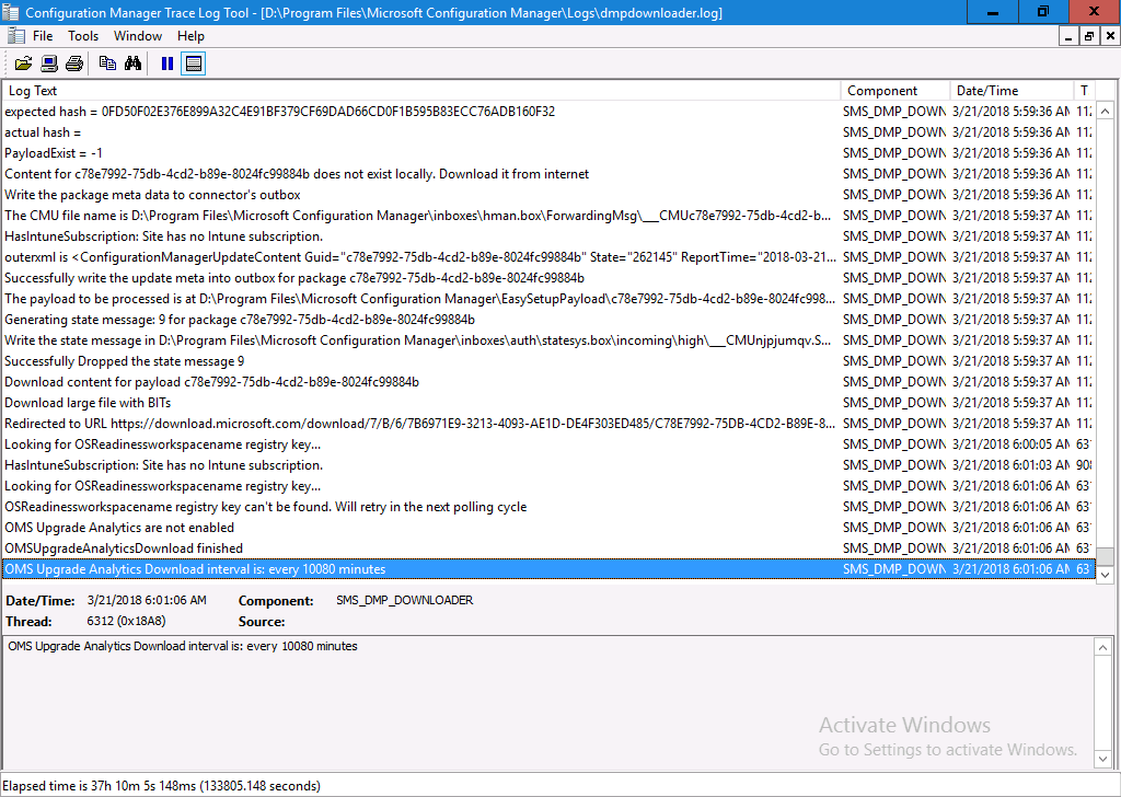

After some time the update will automatically start downloading at which point you can open the dmpdownloader.log using CMtrace to keep track of things.
Once it has completed downloading, the update pack will be listed in the ConfigMgr console with a state of Ready to Install. You may need to click refresh in the ConfigMgr console to update the view.

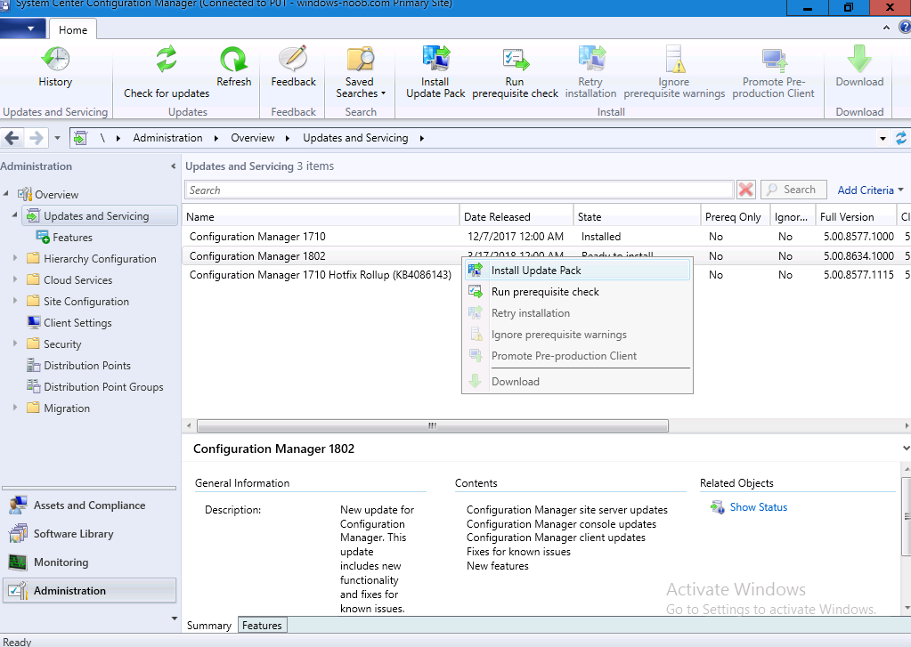

Right click on the update and choose Install Update Pack.

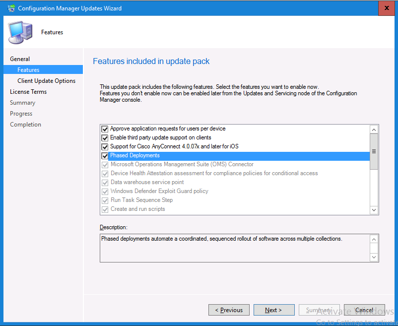

review the features included in this update pack , and make selections if you wish, you can always add them later in the Console.
Note: You'll also notice lots of Pre-Release features that are greyed out, to turn them on see the steps after upgrading the console the bottom of this guide.

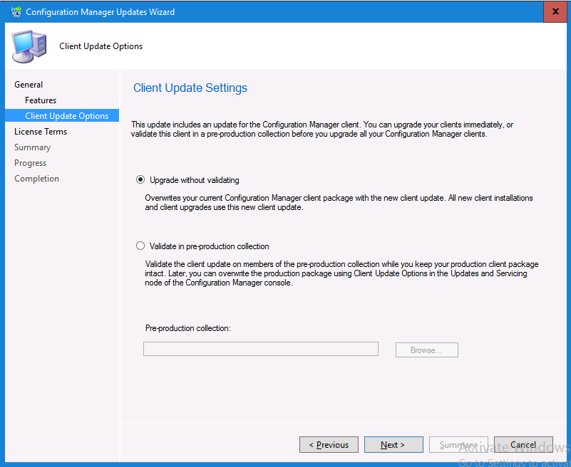

Before clicking next at the Client update settings please see this post

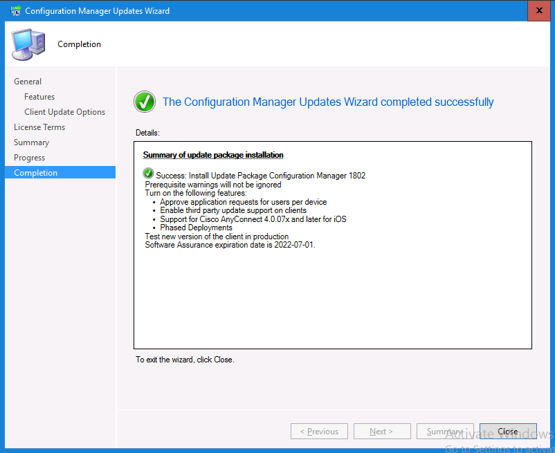

accept the EULA and configure the software assurance expiration date
and continue through until the wizard is complete.

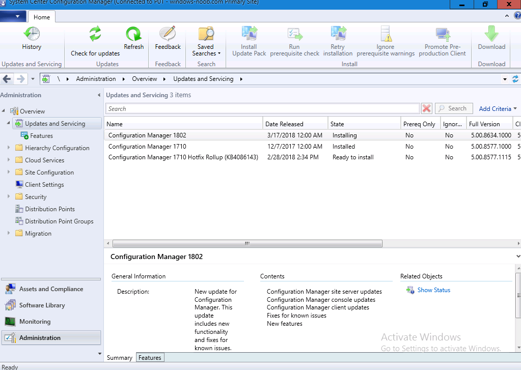

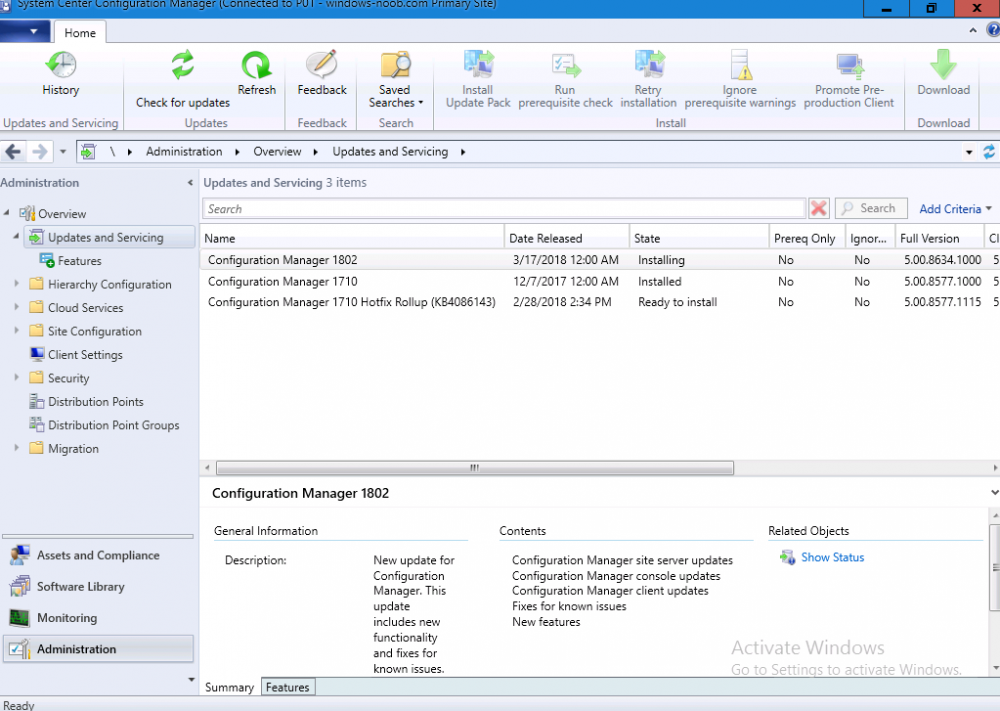

In the console, the update pack state will change to Installing (refresh the console view to see this).
Clicking on Show Status will give you detailed info about the state the Installation is in, there are 5 distinct phases in the top pane:

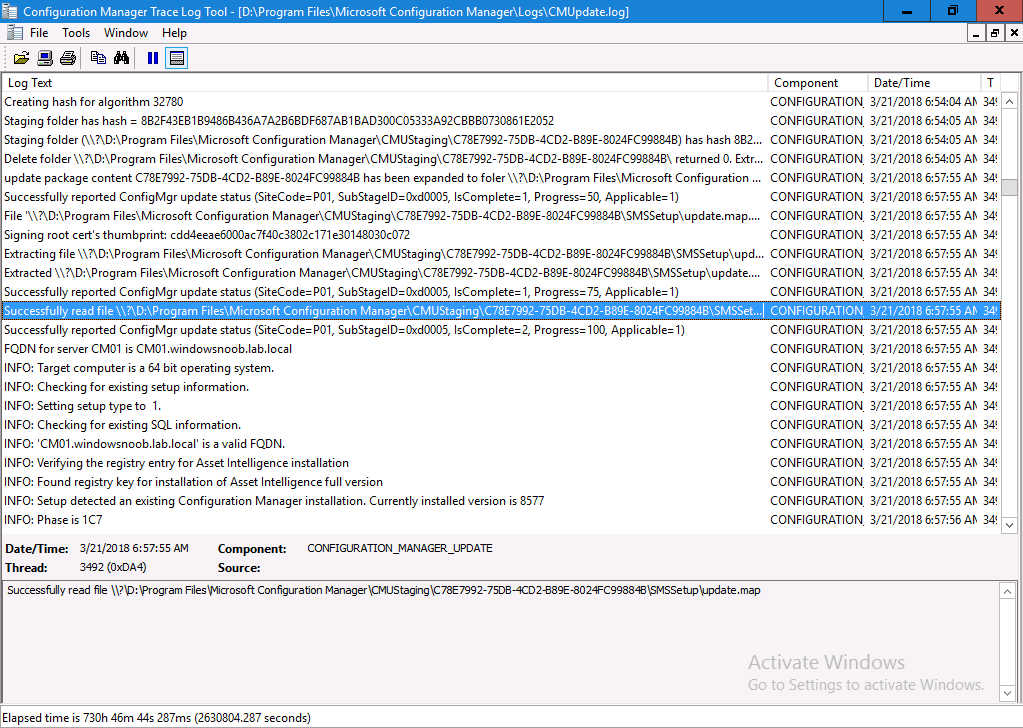

During the upgrade you should monitor the following log files available in <drvletter>:\Program Files\Microsoft Configuration Manager\Logs, you can use CMTrace to do so.
  • CMUpdate.log
  • Hman.log
These logs will detail the installation of the update pack.

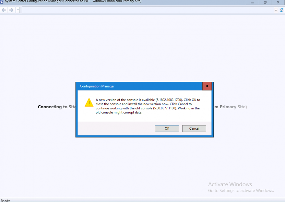

After the update is complete, click Refresh in the console and you'll be reminded to update the ConfigMgr Console via a popup, the new version is 5.1802.1082.1700. Make sure to update your console as you cannot use the new features until you do.
The observant among you will notice a change to the Console versioning. The new console version is 5.1802.1082.1700 versus the old console version (in my lab) which was 5.00.8577.1100. The new Console versioning works as follows:

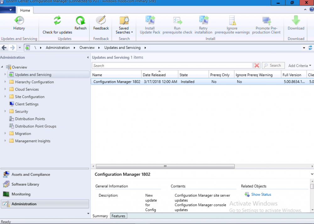

Click OK to upgrade your ConfigMgr console, and after all is done you’ll see the 1802 version listed in the console.

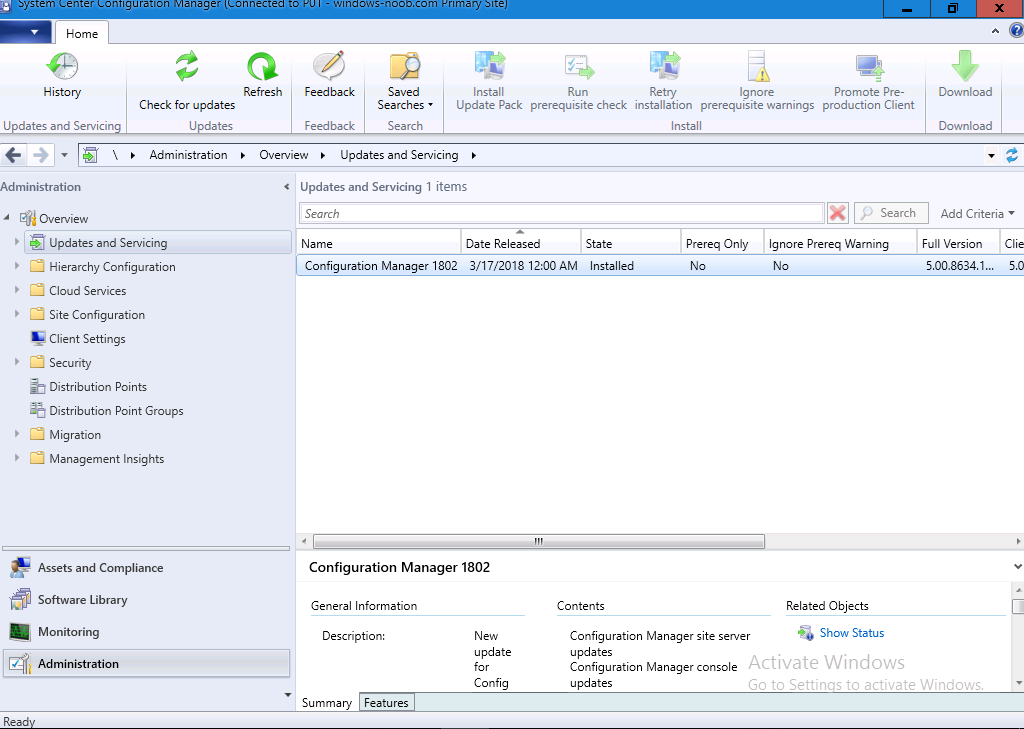

and clicking on about shows you

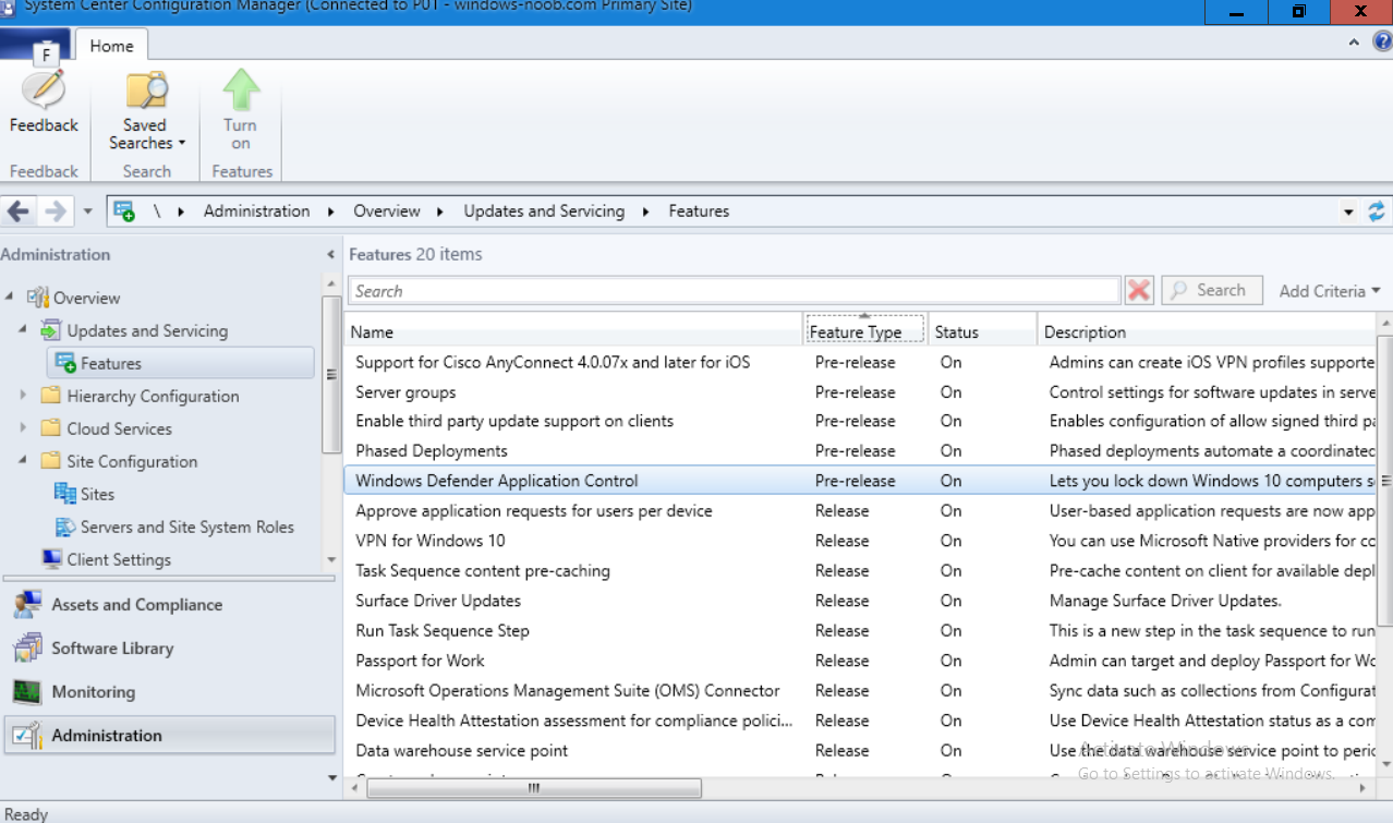

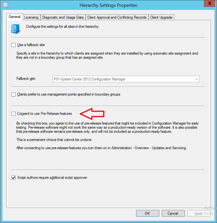

Enabling Pre-release features
If you want to use the Pre-Release features, then select the Administration node, select Site Configuration, Sites, Hierarchy Settings, and place a check mark in Consent to use Pre-Release features.
After that, select Updates and Servicing, click on the Update Pack, select Features and in the right pane of the ConfigMgr console you'll be able to turn pre-release features on or off by right clicking and choosing Turn on or Turn off.

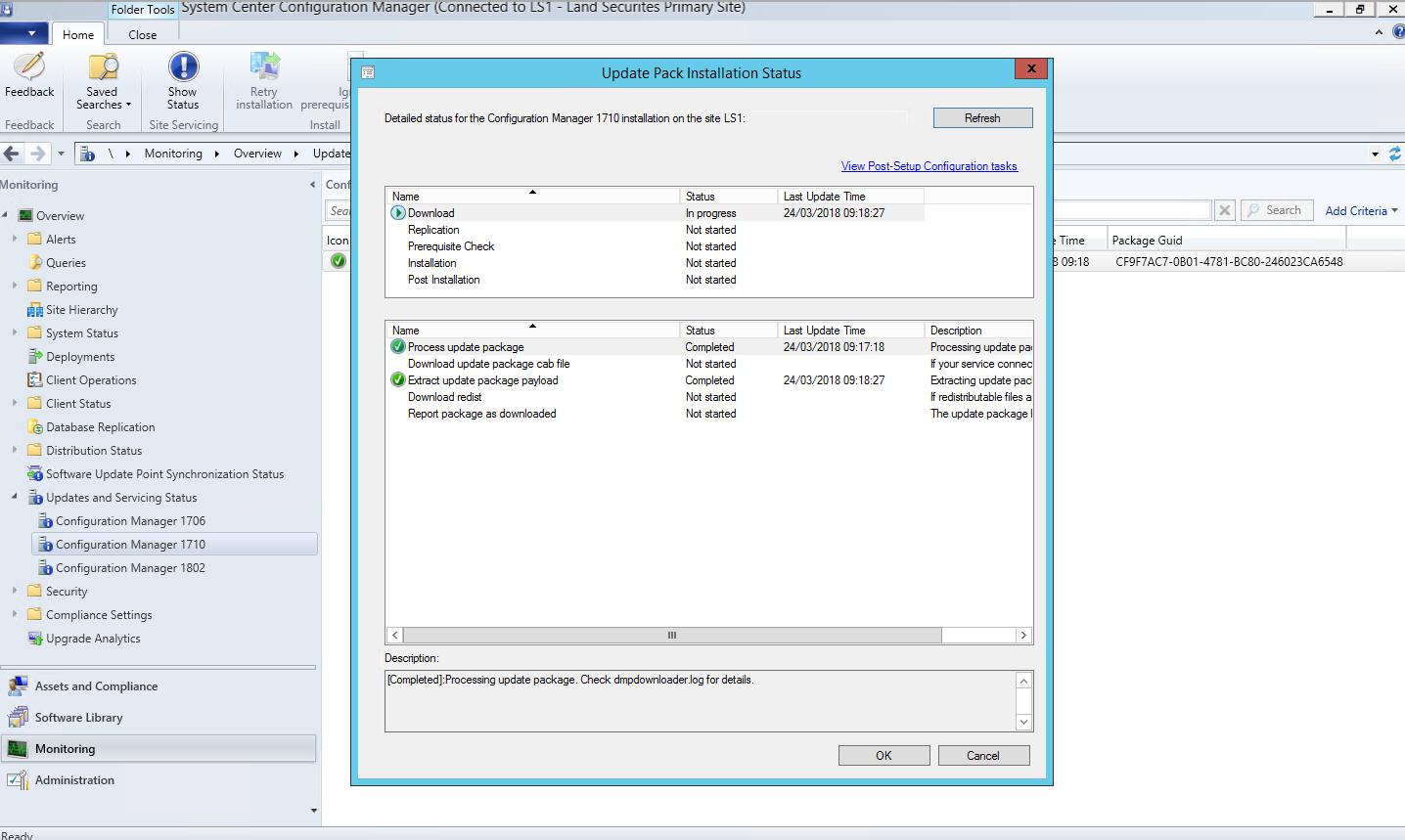

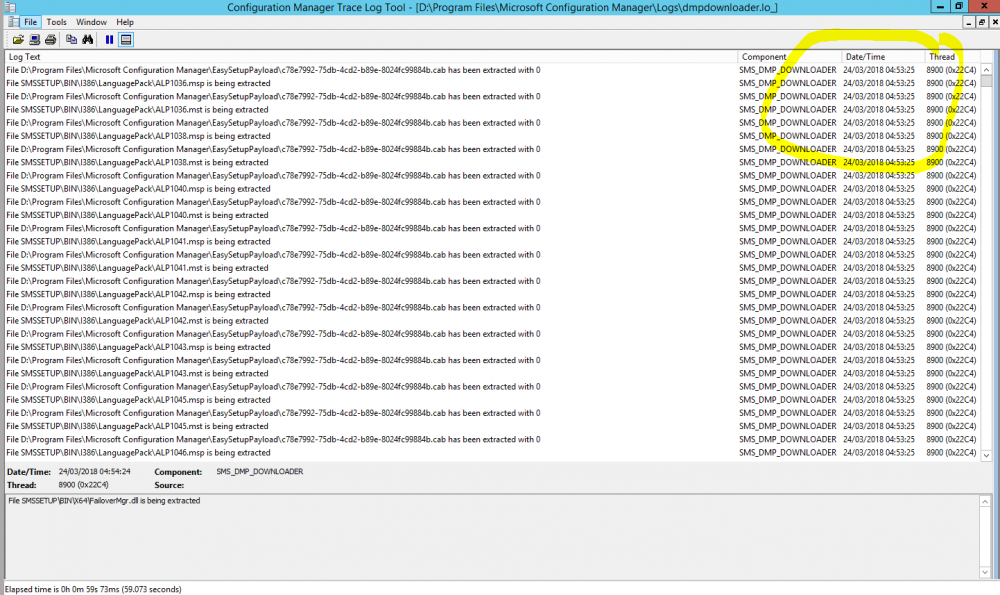

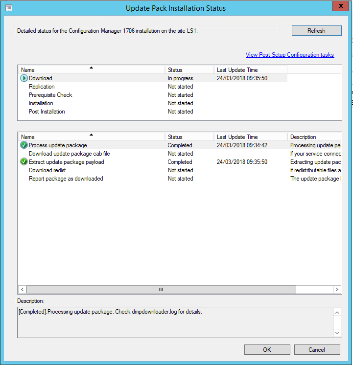

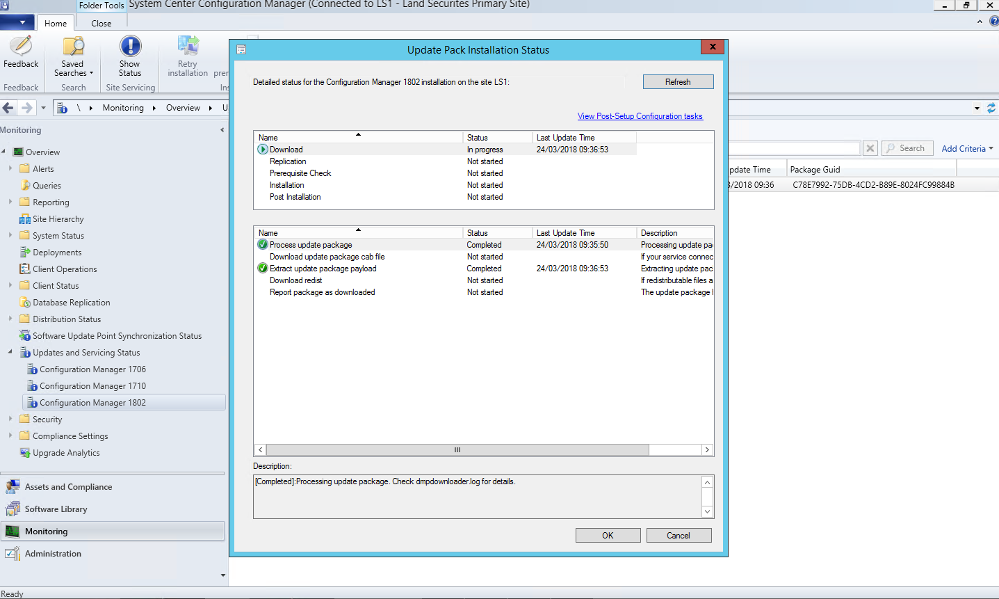

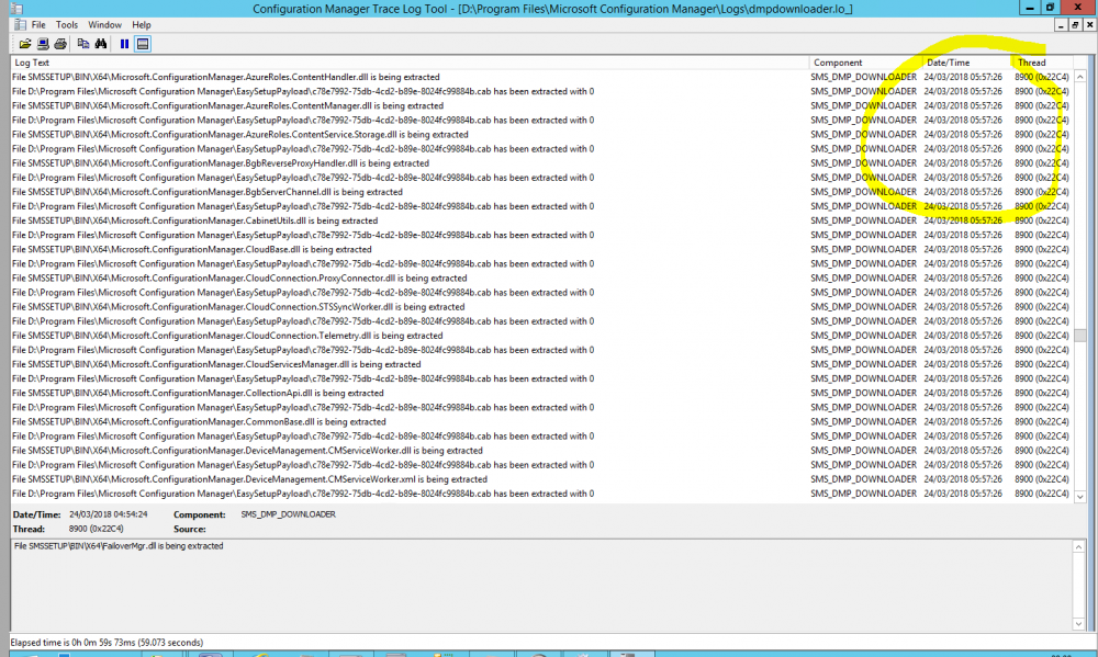

1802 failed to download and breaks 1706 and 1710 download along the way.
Would you mind having a look at my logs?  I have checked and everything looks fine.  No errors.  It kept downloading in a loop.  Look at the time stamp in some of the screenshot.
dmpdownloader.log
dmpdownloader.lo_

Niall, this is the first time an in console update  has failed for me. Updating single Primary Site from 1710 to 1802. I ran the Prerequisite checks and all was good. I then started the installation and all seemed to be good up to failing on the step Upgrade ConfigMgr Database. cmupdate.log showed the generic message Failed to apply update changes 0x87d20b15. Looking further up in the log, I found the line SQL MESSAGE: sp_RenewInvGroupViews - Creating inventory views EXEC sp_RenewInvGroupViews and then right after that
[SQL Server]Invalid column name 'DeviceHardwareData00'. : v_HS_MDM_DEVDETAIL_EXT01 and ERROR: Failed to renew inventory views and rbac functions.
I am including my cmupdate.log in hopes that you could have a quick look through it . . . (the update was started last night) Thanks!
(Note: SQL compat level=110, Login Properties for NT AUTHORITY/SYSTEM has sysadmin Server Role)
CMUpdate.log
what i can see in your log Cordell are the following errors..
*** [08001][-2146893051][Microsoft]
A network-related or instance-specific error has occurred while establishing a connection to SQL Server. Server is not found or not accessible. Check if instance name is correct and if SQL Server is configured to allow remote connections. For more information see SQL Server Books Online.
[Click and drag to move]
*** Failed to connect to the SQL Server, connection type: SMS ACCESS.
*** [28000][18456][Microsoft][SQL Server Native Client 11.0][SQL Server]Login failed for user 'NT AUTHORITY\SYSTEM'.
*** [42000][4060][Microsoft][SQL Server Native Client 11.0][SQL Server]Cannot open database "CM_P03" requested by the login. The login failed.
Failed to update database.
so until you fix the login issues it won't upgrade, is the DB local or remote ?
