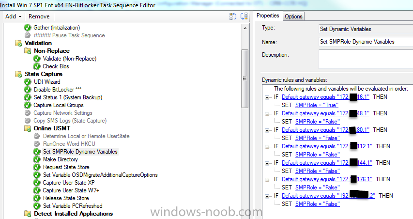

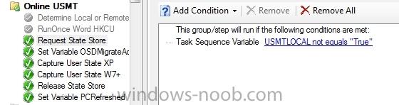

Sorry for the late reply I just finished testing and it's working. I still don't understand why USMTLOCAL=TRUE but her is a screen shot. Thank you -

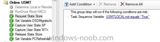

I will give it a shot but it seems I have an issue with the how my TS is evaluating variables. I disabled Determine Local or Remote and still smsts.log shows USMTLOCAL=True. I even tried setting it to False in CS.ini but it still shows up as true in smsts.log, The weird thing is that Request State Store is still processed even though the condition says to run only if not equal true! smsts.log clip Start executing an instruction. Instruction name: Request State Store. Instruction pointer: 38 TSManager 06/06/2014 2:07:50 PM 4064 (0x0FE0) Set a global environment variable _SMSTSCurrentActionName=Request State Store TSManager 06/06/2014 2:07:50 PM 4064 (0x0FE0) Set a global environment variable _SMSTSNextInstructionPointer=38 TSManager 06/06/2014 2:07:50 PM 4064 (0x0FE0) Set a local default variable OSDStateFallbackToNAA TSManager 06/06/2014 2:07:50 PM 4064 (0x0FE0) Set a global environment variable _SMSTSLogPath=C:\WINDOWS\CCM\Logs\SMSTSLog TSManager 06/06/2014 2:07:50 PM 4064 (0x0FE0) Evaluating an AND expression TSManager 06/06/2014 2:07:50 PM 4064 (0x0FE0) Evaluating a variable condition expression TSManager 06/06/2014 2:07:50 PM 4064 (0x0FE0) Expand a string: notEquals TSManager 06/06/2014 2:07:50 PM 4064 (0x0FE0) Expand a string: USMTLOCAL TSManager 06/06/2014 2:07:50 PM 4064 (0x0FE0) Expand a string: True TSManager 06/06/2014 2:07:50 PM 4064 (0x0FE0) The condition for the action (Request State Store) is evaluated to be true TSManager 06/06/2014 2:07:50 PM 4064 (0x0FE0) clip -
Hello I need guidance to accomplish user data backup and restore in a refresh scenario for sites that don't have SMP role. 1 Primary Site: W2012R2, SCCM 2012 R2 CU1, DP, SMP 5 Site System Server: W2003R2, DP (regional sites) I could not get SMP to work properly on W2003R2 although it installed. Documentation seems to indicate SMP role is not supported on W2003R2. I have CustomSettings.ini with DefaultGateway to identify regional sites and it seems to be working in my TS. I added OSDStateStorePath=\\WPG\USMT-Data$. I read online that setting variable OSDStateStorePath should skip "Request State Store" but I'm getting an error on " Request State Store" task step in my TS. I could create another TS for the regions but I would like to keep using a single TS for all. How can I skip a task in a TS based on DefaultGateway? thank you SMSTS.log clip ------ Processing the [DEFAULTGATEWAY] section ------ InstallSoftware 05/06/2014 9:53:06 AM 1936 (0x0790) Match found for default gateway 172.16.111.1, retrieving settings. InstallSoftware 05/06/2014 9:53:06 AM 1936 (0x0790) ------ Processing the [WPG] section ------ InstallSoftware 05/06/2014 9:53:06 AM 1936 (0x0790) Property MACHINEOBJECTOU is now = OU=Winnipeg,OU=Workstations,OU=Computers,OU=xxxxxx,DC=cirb-ccri,DC=com InstallSoftware 05/06/2014 9:53:06 AM 1936 (0x0790) Using from [WPG]: MACHINEOBJECTOU = OU=Winnipeg,OU=Workstations,OU=Computers,OU=xxxxxxx,DC=cirb-ccri,DC=com InstallSoftware 05/06/2014 9:53:06 AM 1936 (0x0790) Property TIMEZONE is now = 020 InstallSoftware 05/06/2014 9:53:06 AM 1936 (0x0790) Using from [WPG]: TIMEZONE = 020 InstallSoftware 05/06/2014 9:53:06 AM 1936 (0x0790) Property TIMEZONENAME is now = Central Standard Time InstallSoftware 05/06/2014 9:53:06 AM 1936 (0x0790) Using from [WPG]: TIMEZONENAME = Central Standard Time InstallSoftware 05/06/2014 9:53:06 AM 1936 (0x0790) Property OSDSTATESTOREPATH is now = \\WPG\USMT-Data$ InstallSoftware 05/06/2014 9:53:06 AM 1936 (0x0790) Using from [WPG]: OSDSTATESTOREPATH = \\WPG\USMT-Data$ InstallSoftware 05/06/2014 9:53:06 AM 1936 (0x0790) clip Number of local SMP's = 0 OSDSMPClient 05/06/2014 9:53:27 AM 5268 (0x1494) Retrieving SMP list succeeded OSDSMPClient 05/06/2014 9:53:27 AM 5268 (0x1494) Looking for UsersList OSDSMPClient 05/06/2014 9:53:27 AM 5268 (0x1494) User List is empty in MigrationInfo from MP. OSDSMPClient 05/06/2014 9:53:27 AM 5268 (0x1494) Successfully processed response from MP. OSDSMPClient 05/06/2014 9:53:27 AM 5268 (0x1494) Contacting available state migration points to service capture request OSDSMPClient 05/06/2014 9:53:27 AM 5268 (0x1494) No state migration points are available to service request. OSDSMPClient 05/06/2014 9:53:27 AM 5268 (0x1494) ExecuteCaptureRequestSMP failed (0x80004005). OSDSMPClient 05/06/2014 9:53:27 AM 5268 (0x1494) ExecuteCaptureRequest failed (0x80004005). OSDSMPClient 05/06/2014 9:53:27 AM 5268 (0x1494) OSDSMPClient finished: 0x00004005 OSDSMPClient 05/06/2014 9:53:27 AM 5268 (0x1494) Process completed with exit code 16389 TSManager 05/06/2014 9:53:27 AM 4932 (0x1344) !--------------------------------------------------------------------------------------------! TSManager 05/06/2014 9:53:27 AM 4932 (0x1344) Failed to run the action: Request State Store. Unknown error (Error: 00004005; Source: Unknown) TSManager 05/06/2014 9:53:27 AM 4932 (0x1344) clip

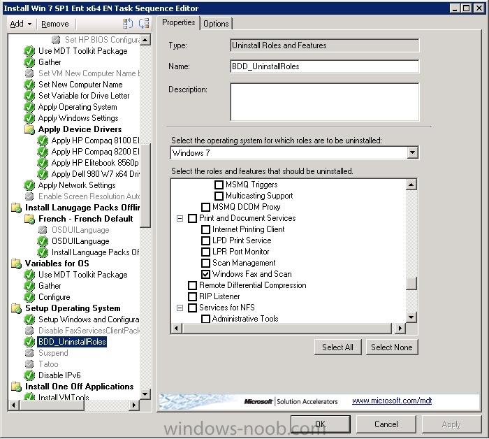

Creating a new MDT Task Sequence resolved this issue, all I have to do now is Copy Paste my tasks from the old TS to the new TS. Would of been nice to know how to fix the old one... -

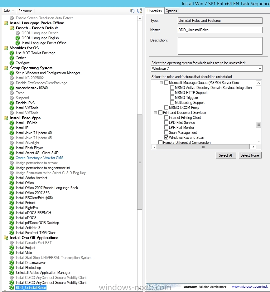

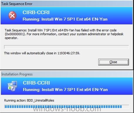

I have a bunch of windows applications that install ok before the BDD_UninstallRoles task. I just did a test and the same error popped up. I should of mentionned that the task sequence was exported from my lab server to my prod server. The servers are at the same level 2012R2. It did not work in the lab either... How can I verify that the "setup windows and configmgr" step is really working? If I don't use the MDT/Uninstall Roles; the OS and ConfigMgr client are installed properly and joined to the domain. -

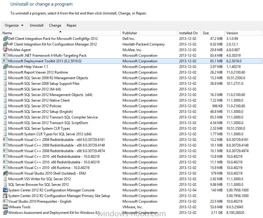

It seems the proper versions are installed and "MDT -> Install Language Packs Offline" is working. What else could I check? -

Unable to add Roles with MDT integration to OSD TS
Yan replied to Yan's topic in Configuration Manager 2012
I'm I the only one using this MDT integration? Can someone confirm that it's working for them in SCCM2012R2 OSD? -

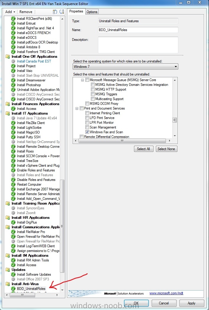

Hello I have a fresh install of W2012R2, SQL2012SP1, ADK 8.1, MDT 2013 and SCCM 2012R2 Hotfix KB2905002 . I had the same errors on another upgraded server to R2. I can't remove or add Roles in a OSD TS. Add -> MDT -> Install Language Packs Offline. Works in a TS Add -> MDT -> Uninstall Roles and Features. Does NOT work in a TS. The install Roles and Features does NOT work also, same error so it seems some MDT integration is NOT working or just the ZTIOSRole.wsf SMSTS.log: <![LOG[This script should only run in the full OS.]LOG]! <![LOG[ZTI ERROR - Non-zero return code by ZTIOSRole, rc = 1]LOG]! <![LOG[Command line returned 1]LOG]!> <![LOG[Process completed with exit code 1]LOG]!> <![LOG[Failed to run the action: BDD_UninstallRoles. Incorrect function. (Error: 00000001; Source: Windows)]LOG]!> ZTIOSRole.log: <![LOG[This script should only run in the full OS.]LOG]! I'm running this after "Setup Windows and Configuration Manager" task so it's in "Full OS" <![LOG[ZTI ERROR - Non-zero return code by ZTIOSRole, rc = 1]LOG]! Removing Fax Services using dism.exe /online /disable-feature /featurename:FaxServicesClientPackage /Quiet /NoRestart is a good workarround but installing IIS6 Tools using dism.exe adds unwanted stuff like Web Server and c:\inetpub. tks

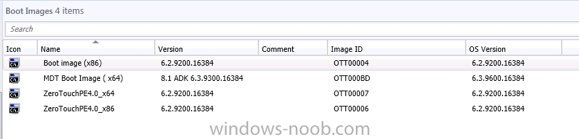

c:\configmgrsetup.lo_ ERROR: Failed to update the default boot image: \\BRAIN\root\sms\site_OTT:SMS_BootImagePackage.PackageID="OTT00005". Error code 0x80041001 Configuration Manager Setup 22/10/2013 12:01:19 PM 12280 (0x2FF8) WARN: Setup does not upgrade customized boot image package. Please update it manually. I'm ok with updating the Boot Images and MDT Toolkit Package manually but I still have an issue with MDT integration: Add -> MDT -> Install Language Packs Offline. Works in a TS Add -> MDT -> Uninstall Roles and Features. Does NOT work in a TS. SMSTS.log: Error: <![LOG[Failed to run the action: BDD_UninstallRoles. Incorrect function. (Error: 00000001; Source: Windows) ZTIOSRole.log: <![LOG[This script should only run in the full OS.]LOG]! I'm running this after "Setup Windows and Configuration Manager" task so it's in "Full OS" <![LOG[ZTI ERROR - Non-zero return code by ZTIOSRole, rc = 1]LOG]! So it seems some MDT integration is NOT working or just the ZTIOSRole.wsf EDIT: The install Roles and Features does NOT work also, same error. smsts-20131024-051327.log ZTIOSRole.log -

I ran the "Create MDT Task Sequence" and recreated the Boot Images and MDT Toolkit as described bellow. Now the version is 6.3.9200.16384. I had no errors in the upgrade log so I don't know what appened but it seems my upgrade wasn't 100%. http://www.windows-noob.com/forums/index.php?/topic/5131-using-sccm-2012-rc-in-a-lab-part-16-integrating-mdt-2012-rc1-with-configuration-manager-2012/ -

6.2.9200.16384 -

Any chance you can include how to upgrade the Boot Images to WinPE 5 and MDT Package? I Upgraded to CM 2012 R2, MDT 2013, AIK 8.1. and my task sequence stops at BDD_UninstallRoles (MDT integration). I'm assuming I have to update the MDT integration, MDT Package and Boot Image files. I did run the Configure ConfigMgr Intergration to remove and then readd the integration. I did delete the task BDD_UninstallRoles and recreated it. Any help would be appreciated. tks n00b -
