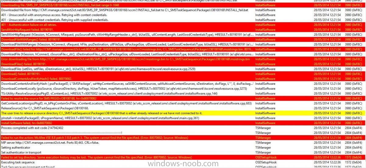

This is an intermittent issue which is happening on the occasional device. We are not imaging many machines, about a dozen devices a day at the moment. The vast majority work, there is only the occasional failure due to this reason. In other words, the account is not locked, not expired and not disabled and works nearly all of the time.
This is a task sequence which is run fairly regularly without issues. The package OB100168 is used in every deployment and has no issues normally. Therefore I am starting to believe there is a network issue somewhere. Can anyone see from the attached if that is the cause? smsts.log
