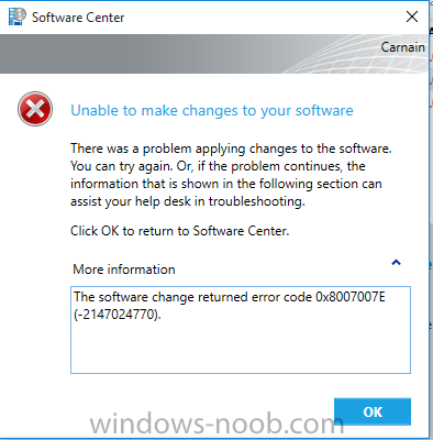

  3. Hello Again I've checked the logs and the cant find what you have there? I thought that those logs were just for installing the OS? In my SCCM console i dont have two updates for Upgrade to Windows 10 Enterprise, Version 1511, 10586 - en-us, Volume Just one and the Clients have evaluated it to be required. The error code does not match mine 0x8007007e. Will try settings up a another test environment and test there. Will post my result here later
  4. Hello I have a strange issue that I hope people can help me With. I'm using SCCM to push out the 10586 update I have 4 Windows 10 enterprice 10240 machines With all updates Applied. When I try to update my machine the following error comes The software change returned error code 0x8007007E.(-2147024770). The download of the update worked fine and everything looks ok before I start. The update is available in Software Center and downloads the update to the Client. The UpdatesHandler.log shows: WSUS update (5beaec8f-fe8f-4a81-830e-b1aaaaf6a76c) installation result = 0x8007007e, Reboot State = NoReboot Update execution failed. WindowsUpdate.log shows Requested file 10586.0.151029-1700.th2_release_CLIENTENTERPRISE_VOL_x64fre_en-us.esd has no decrypt information Installer completed. Process return code = 0x8007007E, result = 0x8007007E, callback pending = False Exit code = 0x8007007E And nothing more. Anyone else done the same thing? Regards Øyvind Nernæs
