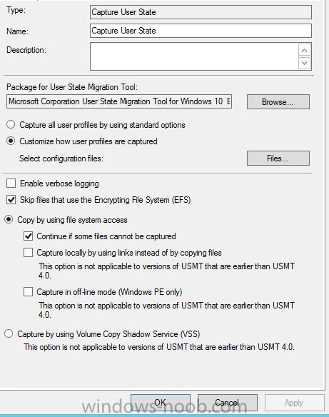

I’m trying to use USMT on a windows 10 pc to the same PC. Ideally Id like to keep the format and partition step as normal which is why I’m trying to use the SCCM migration point to store the files. I have put in the first step- request state store followed by - capture user state Then at the end of the TS Release user state store – restore user state currently using USMT 5.0 is there any other options I need to change in order to do the above
