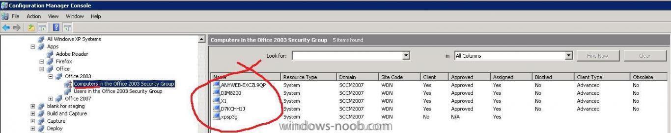

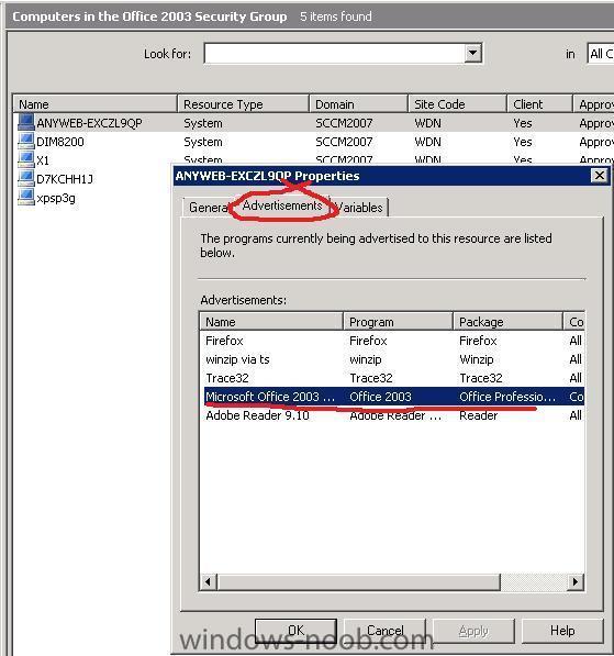

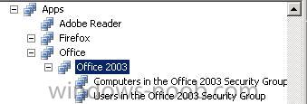

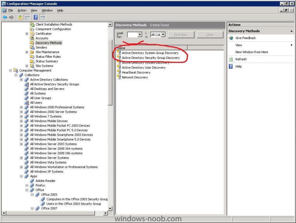

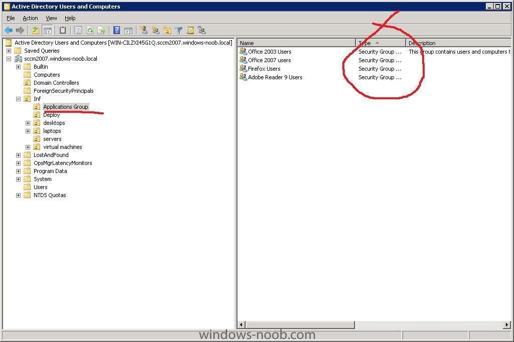

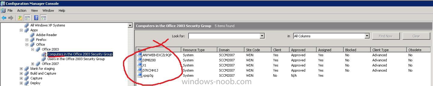

its easy to do but you need to first decide if you want to deploy software to USERS or COMPUTERS the recommended way is to deploy software to COMPUTERS otherwise things can get messy (think one user using multiple computers...) you will also have to enable Active Directory Discovery using the following two Discovery Methods in SCCM Active Directory System Group Discovery Active Directory Security Group Discovery once done... in Active directory you need to setup a structure for this, You will need to create some Active Directory Security Groups, and then create an OU in Active Directory and call it Applications Group now, you need to create your corresponding Collections in SCCM, so lets create three new collections Office 2003 Computers in the Office 2003 Security Group Users in the Office 2003 Security Group The two sub collections will have separate queries to determine their contents: The query for Computers in the Office 2003 Security Group shall be select SMS_R_SYSTEM.ResourceID,SMS_R_SYSTEM.ResourceType,SMS_R_SYSTEM.Name,SMS_R_SYSTEM .SMSUniqueIdentifier,SMS_R_SYSTEM.ResourceDomainORWorkgroup,SMS_R_SYSTEM.Client from SMS_R_System where SMS_R_System.SystemGroupName = "SCCM2007\\Office 2003 Users" so from the above, SCCM2007=your domain and Office 2003 Users is the Active Directory Sercurity Group you added Computer Objects to. Note: To define collection queries please read this post The query for Users in the Office 2003 Security Group shall be select SMS_R_USER.ResourceID,SMS_R_USER.ResourceType,SMS_R_USER.Name,SMS_R_USER.UniqueU serName,SMS_R_USER.WindowsNTDomain from SMS_R_User where UserGroupName = "sccm2007\\Office 2003 Users" Now you can target these sub collections with software to install, so in this case you would target the collections above with an advertisement to install Microsoft Office 2003. once done, you can start adding computer or user objects to the respective Active Directory Group in active directory, and based on your Discovery Methods schedule they will appear within the correct Collection and based on the collection they are in they will receive the correct advertisement, as this is a common question, I have renamed the topic, and pinned it. Related steps: How can I deploy an application using SCCM 2007 SP1 ? How can I target an application to specific hardware using SCCM 2007 SP1 ? how can I deploy Windows Vista SP1 using SCCM 2007 SP1 ? how can I deploy Windows XP SP3 using SCCM 2007 SP1 ? how can I deploy Windows Server 2008 using SCCM 2007 SP1 ? cheers anyweb
