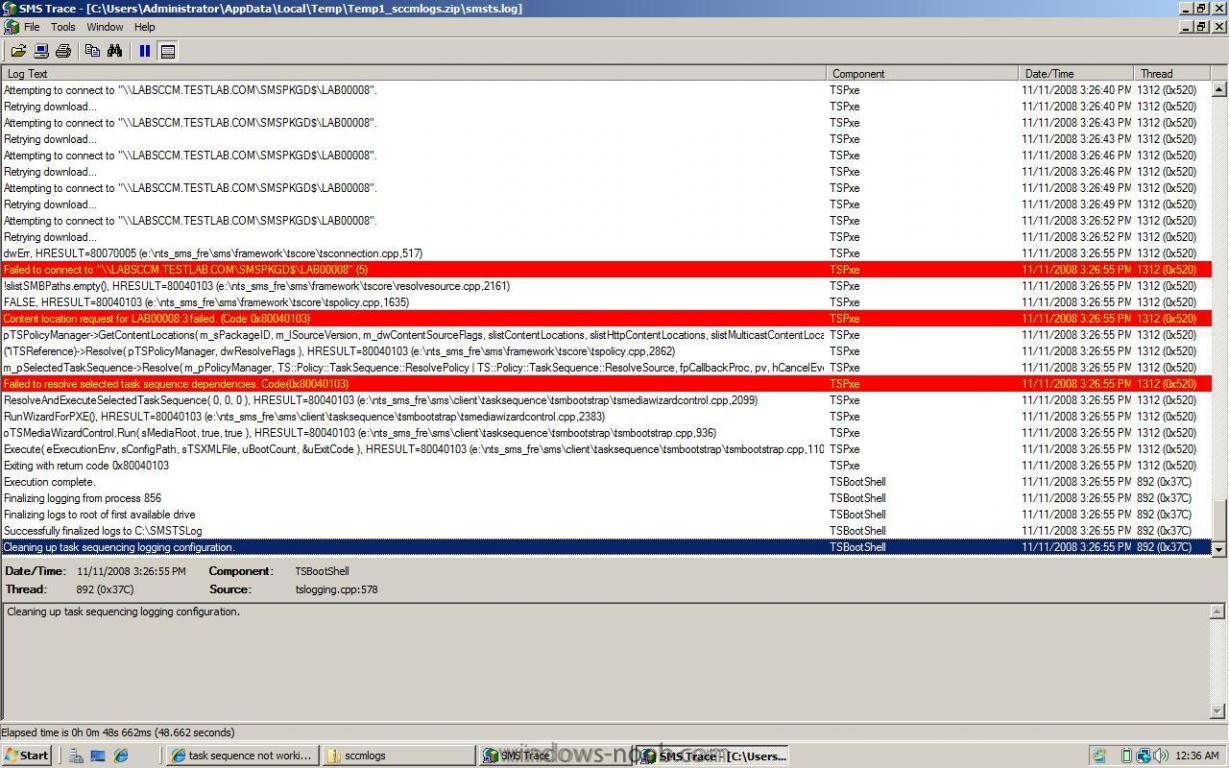

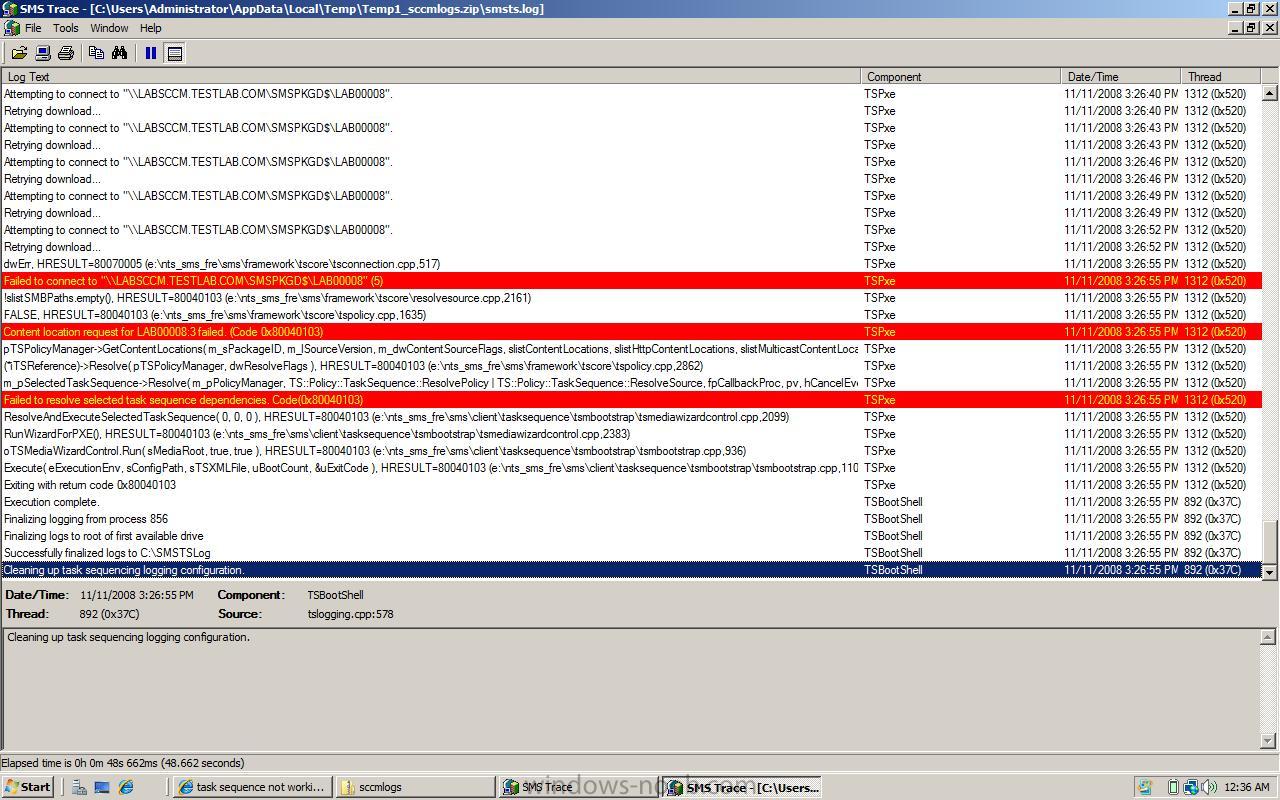

how can I troubleshoot Windows PE booting in SCCM
anyweb replied to anyweb's question in Troubleshooting, Tools, Hints and Tips
got this error last night while trying to install software (ignore the fact that I mention a hotfix, it actually doesnt matter), it turns out it failed because i hadn't defined my regional settings in the test task sequence, meaning that the SCCM server and Client were about 8 hours apart time wise, once I set the timezone in the task sequence to the same as the server I was deploying, the error disappeared and the TS completed normally. -

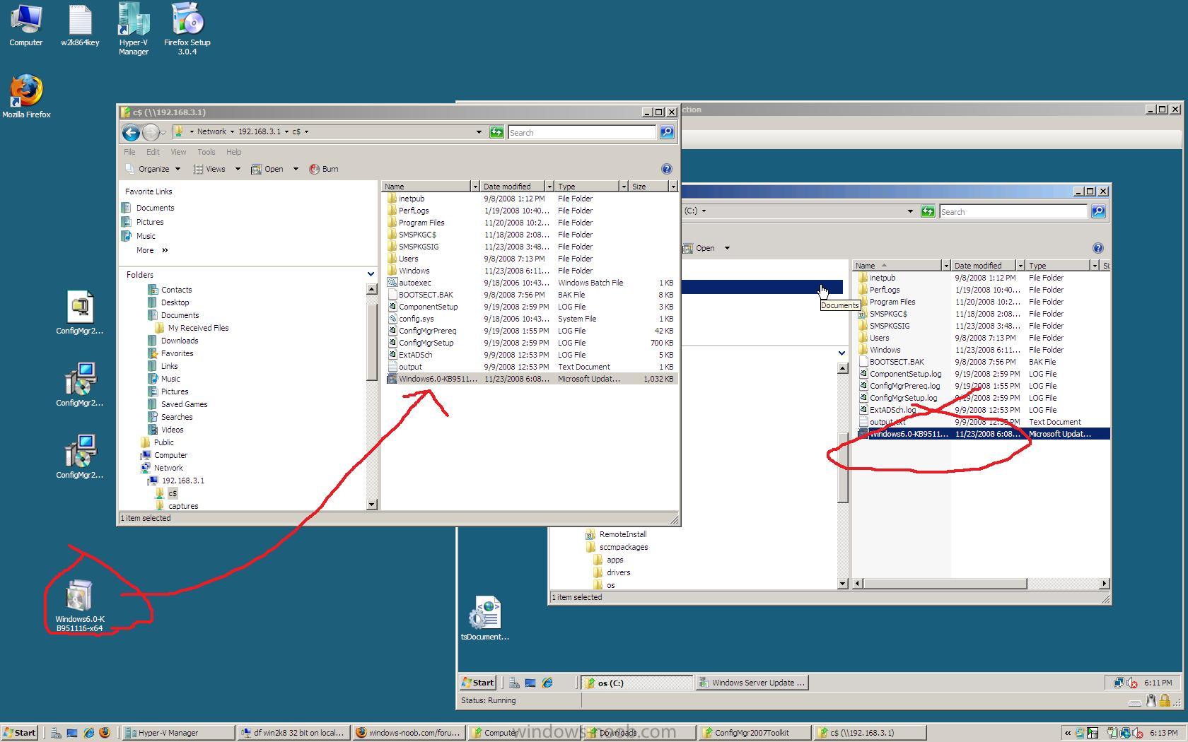

those of you used to Microsoft Virtual PC will find it odd that you can no longer drag and drop files from your desktop to the virtual machine in Hyper V, but all is not lost, you can copy/paste files to/from the Virtual machine by using standard network sharing, in the screenshot below I first connected to my virtual machine using Windows Explorer and browsed to the C$ share on the virtual machine, i then dragged a file from my desktop to that share, and you can see the file is present locally on the virtual machine which is also shown on the desktop (to the right) f.y.i

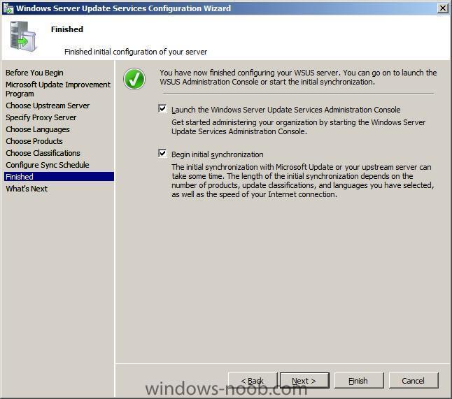

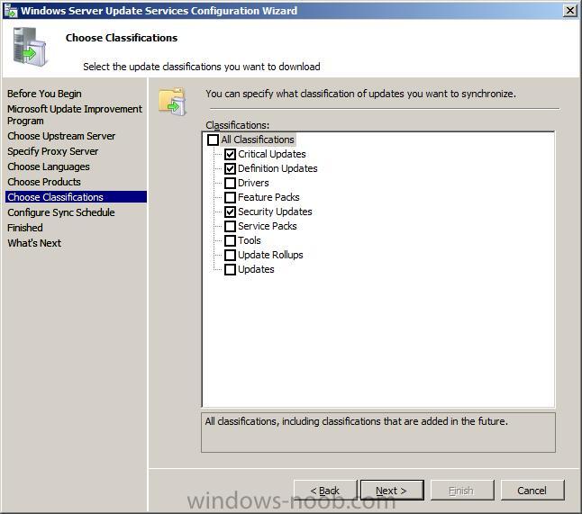

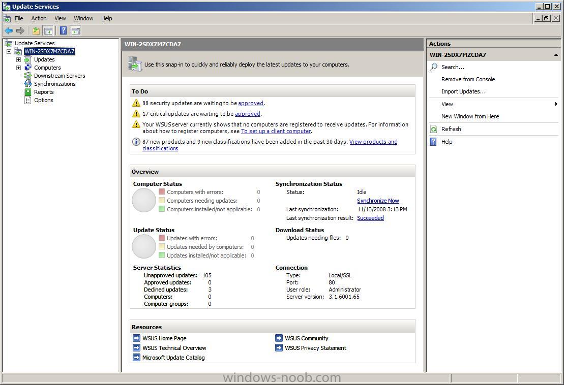

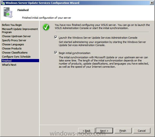

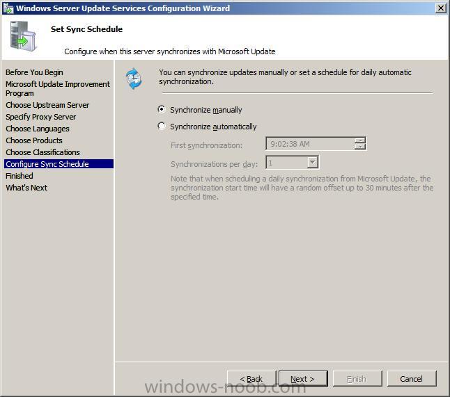

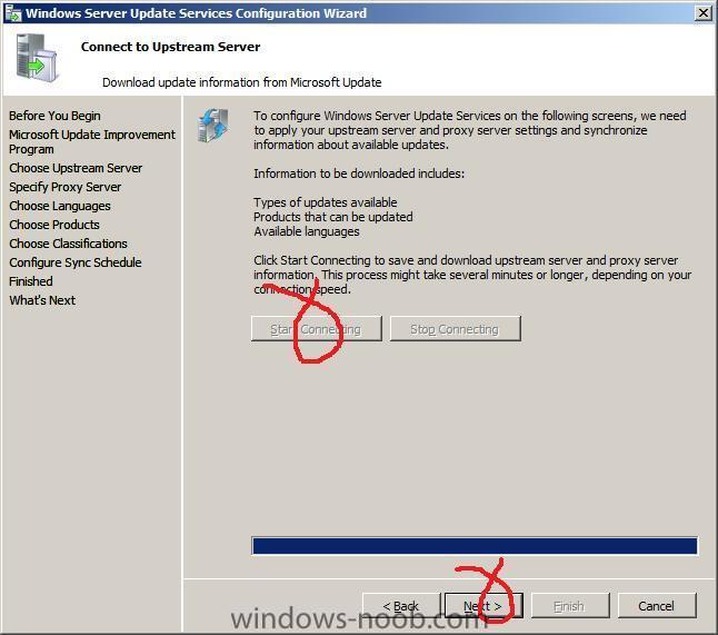

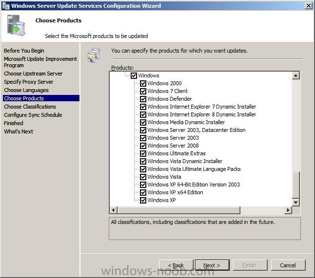

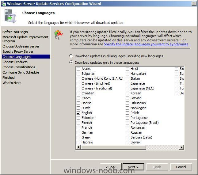

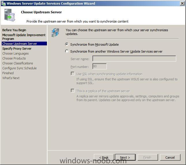

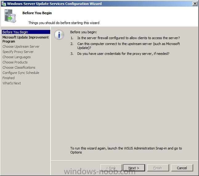

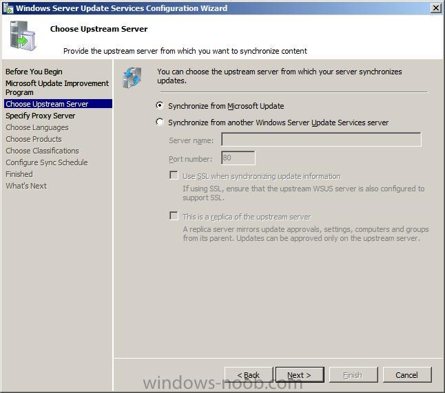

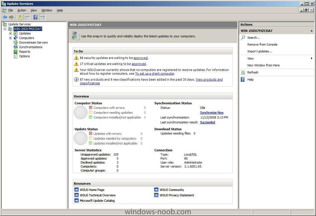

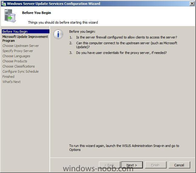

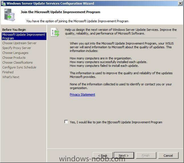

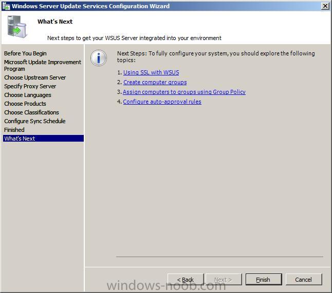

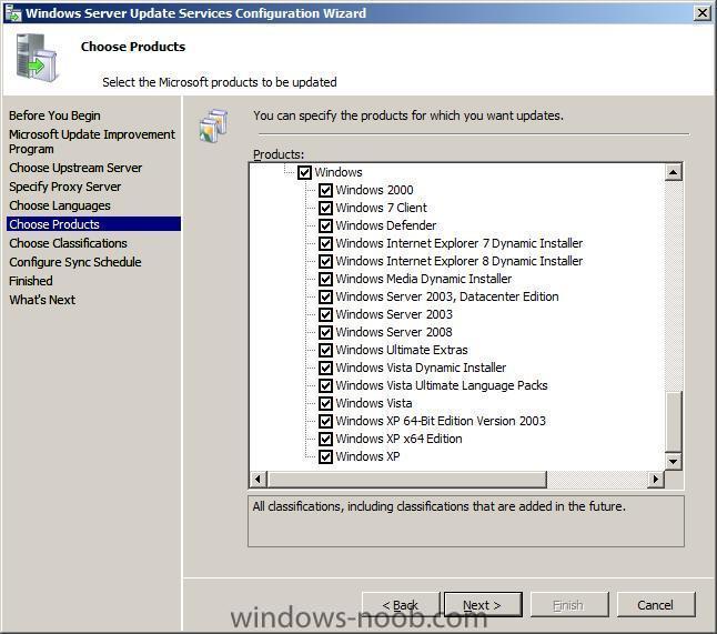

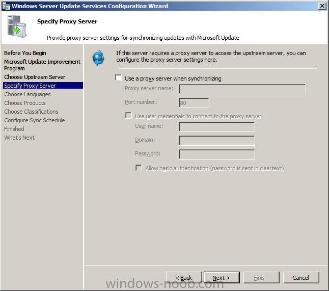

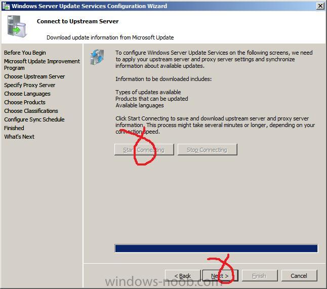

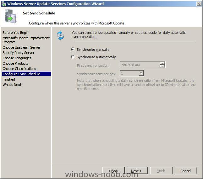

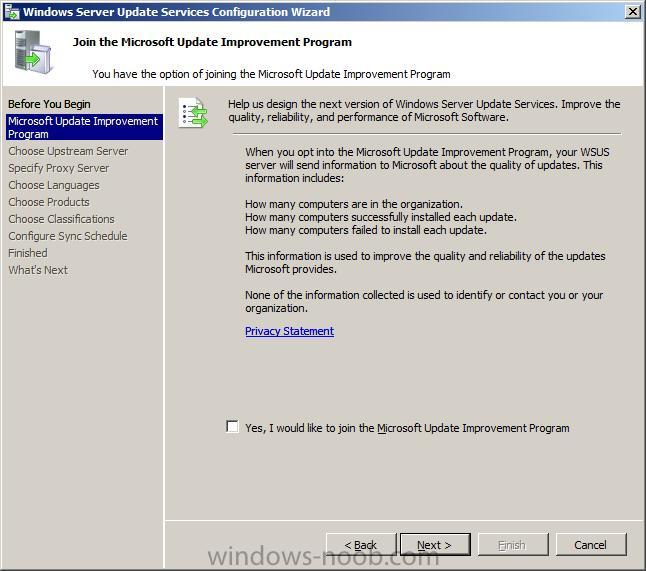

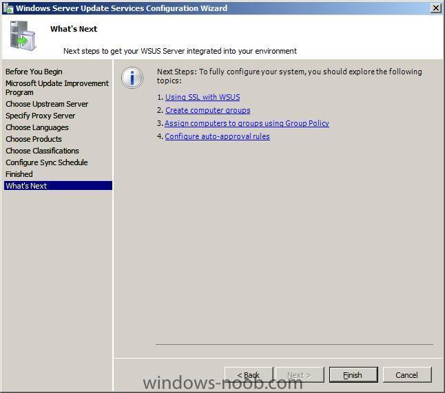

Note: if you are going to use SCCM to manage patch management, then do NOT run the WSUS configuration wizard below Starting WSUS for the first time Click on Start/All Programs/Administrative tools/Microsoft Windows Server Update Services 3.0 SP1 this will start a wizard (pictured below) click next choose to opt in or opt out (default is opt in) Next you can choose your Upstream Server, I stayed with the default option enter your proxy settings (if any) click next and then start connecting once the Wizard has synchronized information with the Microsoft Update web servers you can click next to continue next you get to choose which languages to support and which Microsoft Products to support by default all office versions and all windows versions are selected, remove those which you don't need as all of these updates etc will take up storage space next you can choose what type of updates to download pick a schedule to synchronise finished ! review next steps and then click on Finish to end the wizard. At this point you can now use the WSUS UI Troubleshooting: verify the following LOGS to see how WSUS installation went. MWusSetup.log WSUSSetup.log WSUSSetupmsi_100211_2212.log the last LOG will have it's name based upon the installation date/time as you can see. These logs will be found in the users AppData\Local\Temp folder eg: if the user that installed WSUS was SMSadmin then these logs will be found here: C:\Users\smsadmin\AppData\Local\Temp\ next steps >> how can I configure WSUS to deploy updates

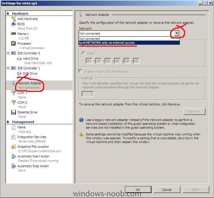

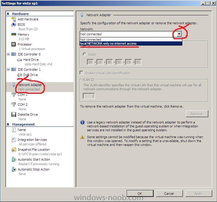

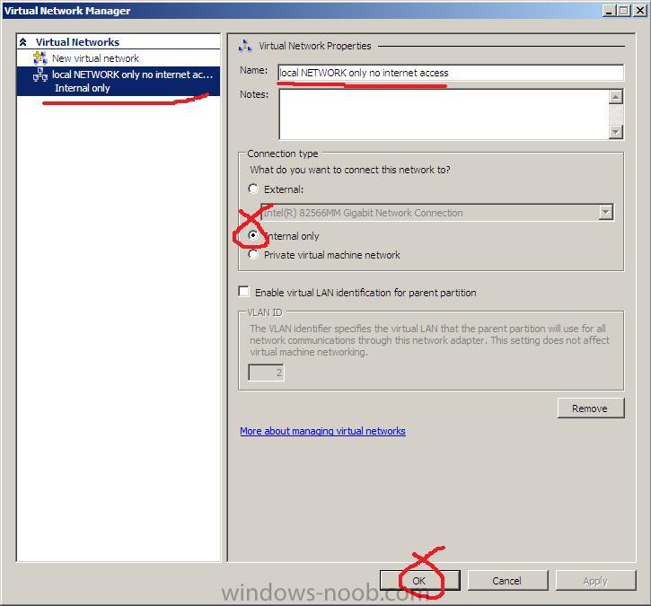

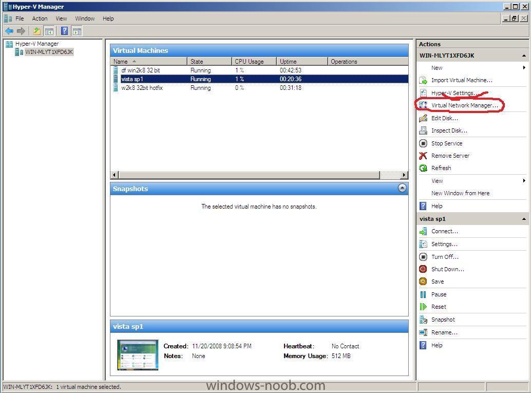

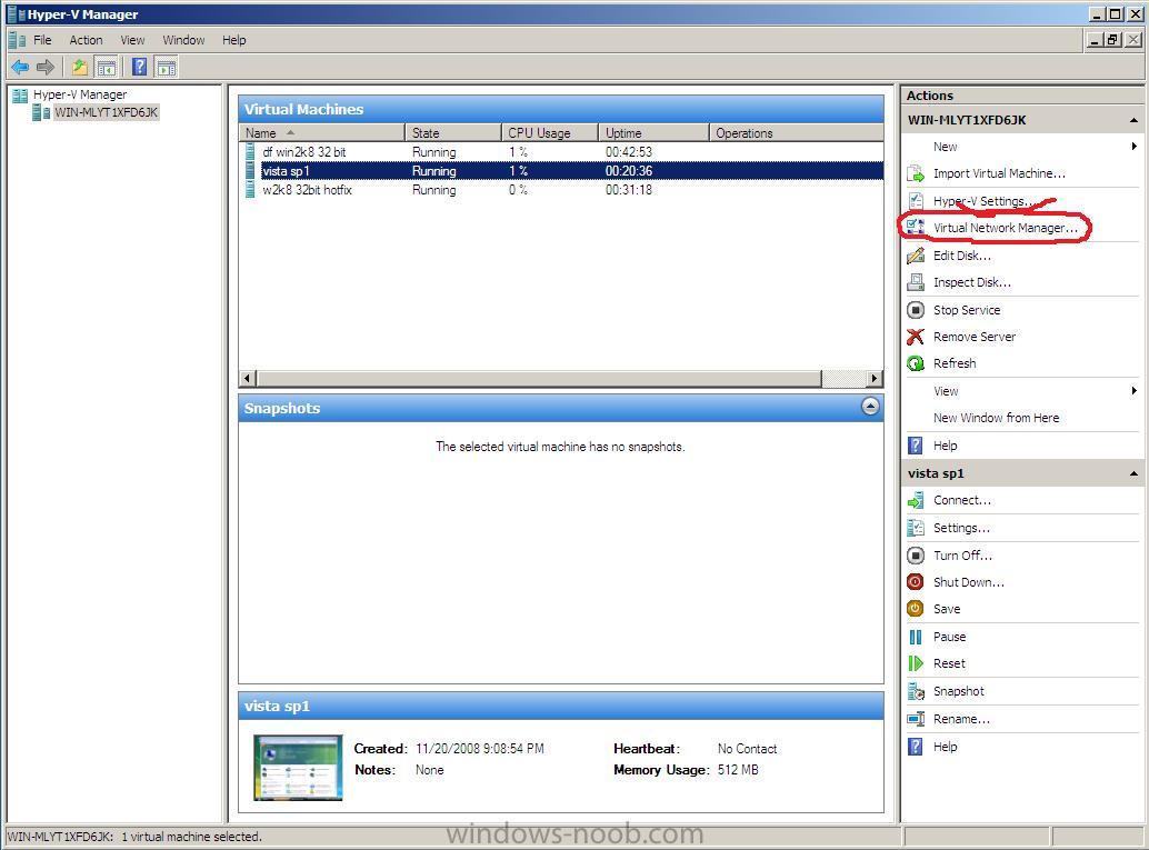

If you have just installed Hyper V in Windows 2008 Server and start a new VM and click on it's settings, you may notice that the network adapater does not have any option except 'Not Connected' in the drop down menu. The solution is simple enough go into Hyper V Managerand right click on your Server (or in the Actions Pane on the right), choose Virtual network Manager, click Add, and choose an External, Internal or Private network, give it a name (like Local network only...) once done click apply, Now go back to your VM and click on settings, Network Adapter, you should now be able to choose the drop down menu and select the new virtual network you just created cheers anyweb
