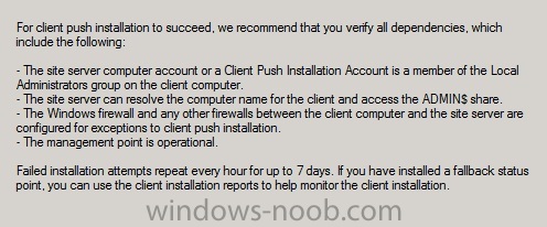

update sccm 2007 agent to sccm 2012 agent
Eswar Koneti replied to diablo's topic in Configuration Manager 2012
good that, all the depencies needed for client push installation added to the client push installation wizard -
