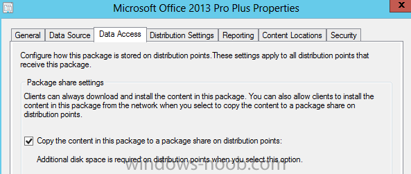

	Hi folks! Runing into an issue when im deploying Applications. When i deploy packages i can chose the following. How do i run applications from the dp directly? both from the TS and from Software Center, any ideas? BR Oneone
