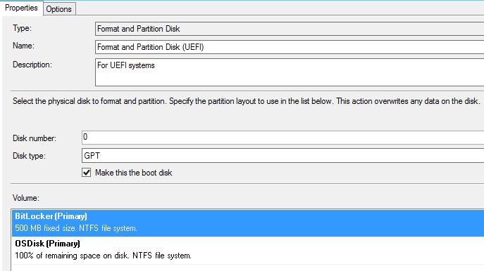

Arrghhh! I hate it when it's that simple! Shoot me now! It seems that it needs a minimum of the EFI partition in order to work (at least in the testing i've just carried out). Do you happen to use these EFI and MSR partitions for anything or are they just "empty"? A sincere thank you. Have a virtual pint in The Strand on me.
Title says it all really. Disk to setup as a GPT, UEFI boot drive. Task Sequence starts, image gets laid down. TS errors out with a "system partition not set" error in smsts.log. The partitioning step sets 2 separate partitions. I've attached screenshots of the partitioning steps. Anyone have any ideas? Probably some stupid mistake on my end.
